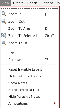

How to configure cdsinit for enabling custom hotkey in Cadence Schematic for hiding terminal & instance labels? For example, to remove probed nets, I have
hiSetBindKey("Schematics" "0" "geDeleteAllProbe(getCurrentWindow() t)")
    Use Options->Log Filter to turn on "Accelerated input" (in the CIW), then execute the menu. You'll see then that the functions called are: _schHiToggleLabels("instLabels") _schHiToggleLabels("termLabels…
    _schHiToggleLabels("termLabels")
    So those are the functions you'll need to use in your bindkey definitions:
    hiSetBindKey("Schematics" "1" "_schHiToggleLabels(\"instLabels\")")

    Thanks Andrew. It's working.
    hiSetBindKey("Schematics" "2" "_schHiToggleLabels(\"termLabels\")")
