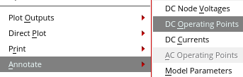

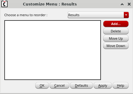

Maestro results > right click on particular corner results > Customize Menus option is not working. It's not adding any options when selected & tried to add. Just empty box. I want to add DC Operating Point & Transient Signal to the main menu.

    I'd never even noticed this "Customize Menu" menu before. Perhaps try deleting the ~/.cadence/RMBCustomization directory and see if that helps. If not, contact customer support - it will need some investigation.

    I don't have this RMB directory. I will check with support. Thanks Andrew.
