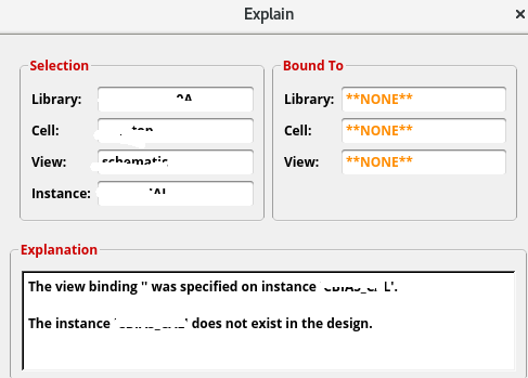

    Andrew Beckett over 4 years ago in reply to sjwprcker
    Can you try using Right Mouse->Explain over the instance in the tree in the hierarchy editor to see if it throws any light on what's going on? It's a little odd that all three are NONE - normally the lib/cell or cell would still be defined.
    Otherwise, I'd suggest trying running oaScan on the schematic with this instance (from the terminal):
    oaScan -lib mylib -cell uppertb -view schematic
    If this complains about anything, you can run again with the -repair.
  • sjwprcker
    sjwprcker over 4 years ago in reply to Andrew Beckett
    This is the explalin result
    Ah, that helps. Now I can reproduce it. The issue occurs if you had an instance binding on the instance which is then removed from the schematic. You can solve this by using Right Mouse->Set Instance View-><none> - then recompute the hierarchy and it will be removed from the hierarchy editor.
    What it's doing is showing you the fact that the instance (or occurrence) binding still remains in the config (even though it will have no effect) - setting it to none removes the binding.

    I was going to ask you to share the expand.cfg file within the config view but since you've smudged out the names on the image above, that's not going to help much. I would expect there to be an entry in the expand.cfg for the offending instance in the containing cellView - something like:
    inst (mylib.uppertb:schematic).I2 binding :functional2;
    and then after setting the binding to <none> and saving (actually you don't even need to recompute the hierarchy - saving is enough), it will vanish from the file.
    If that's not working, you should contact customer support. I even tried in ISR24 just to check and it behaves for me there.
