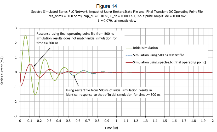

    If it is helpful at all, I assembled a set of specific instructions with examples of using the various options as this issue has been raised a number of times. Further the terms used appear to be a source of confusion. If you are invested kenc184, I've placed the note at URL:
    www.dropbox.com/.../save_state_spectre_tran_sim_directions_results_sml_generic_091021v1p0.pdf
    I will also add that there is an example of the error that can be present when one uses the final transient operating point to restart the simulation in lieu of saving the circuit state. To save you or anyone with an interest some time, I've included Figure 14 from the note below.

    First of all, thanks for posting your document - always good to have real life guides from somebody other than me! I'm also going to caveat what I'm saying here by reiterating that the writefinal/readns/readic approach is the wrong way to do this (as I said before). Now...
    I'm pretty certain that this simple circuit would have worked OK if you'd used readic="spectre.fc", skipdc=yes, start=500n on the transient. There's nothing in the circuit (I think) that would require additional state information (usually this is things like delays, nport, verilog-a models with internal state and so on). I didn't try to reproduce it, so I may be wrong. However, my point is that even if it can be made to work, it's very easy to get wrong and also not be aware of the fact that not everything is saved. For example, here you really need to use skipdc=yes and readic and also make sure that the start time is later so that the PWL source doesn't fire again.
    So the summary (from both of us) is to use the save/recover mechanism because that's much more robust and easier to use...

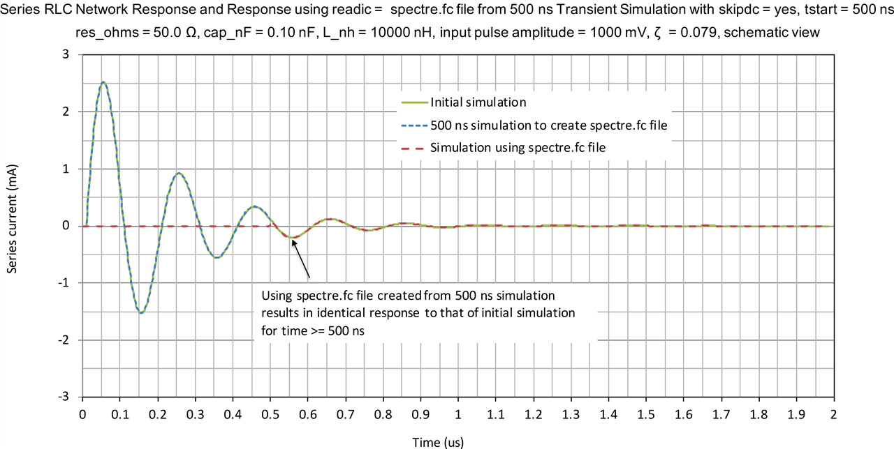

    Dear Andrew and kenc184,
    First, thank you very much Andrew for even taking the time to review my post! I will never understand how you manage to fit "all of us" into your schedule!!
    You are absolutely correct - although I don't think you need to force the simulator to skip the DC operating point as it will choose the operating point from the spectre.fc file. I purposefully chose a test circuit that included an inductor current - whose value is a state variable. If one does not specifically save all the state variables at the last simulation point of one's initial simulation and set the state variables in the subsequent simulation to that value, the resulting re-started simulation will not produce the response of the simulation after the time point at which it was restarted.

    Therefore, the re-started simulation does produce the expected response after the stop point of the prior simulation. I verified this in a few simulations and show the result in Figure 1. Although I do not include it below, I did also verify that without checking the "yes' radio button for skips, the results are the same.
    Figure 1
