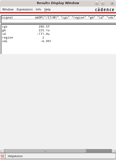

how to show specific parameter in the Results Display Window instead of showing all the parameter (i.e. i want to display only cgs, region, gm, id and vds)

    Andrew Beckett over 4 years ago in reply to ShawnLogan
    Further to Shawn's suggestions, it's not really possible to directly do this via the Results Display Window, but with a bit of SKILL code you can do with provided you don't mind manually editing an expression.
    First of all, put the code below in a file (e.g. abOP.il) and then load in the CIW or .cdsinit: load("abOP.il")
    Then use Results→Print→DC Operating Points and select the instance you want. You'll get all of the parameters shown in the window.
    Next in the Results Display Window, use Expressions→Edit and select the entry with the expression - for example:
    OP("/I7/M1" "??")
    and change this to:
    abOP("/I7/M1" "cgs" "region" "gm" "id" "vds")
    Press the "change" button, and then you should get:
    Here's the SKILL code:
    /* abOP.il
    Author     A.D.Beckett
    Language   SKILL
    Date       Jul 30, 2022
    Modified
    By
    Produce an output similar to OP(instName "??") but with a specified
    list of parameters only, rather than all. Useful with ocnPrint
    or the results print window in ADE
    abOP("/I7/M1" "gm" "gds" "id" "ids")
    SCCS Info: @(#) abOP.il 07/30/22.17:43:44 1.1

  • henker
    henker over 4 years ago in reply to Andrew Beckett
    The initial argument check
    if( listp(param) then
      copy(param)
    else
      list(param)
    could be extended with e.g.
    cond(
      (listp(param)    copy(param))
      (stringp(param)  parseString(param))
      (t               list(param))
    so you could additionally give all the parameters as single string e.g. abOP("/I7/M1" "cgs region gm id vds"), which might get usefull under certain circumstances.
