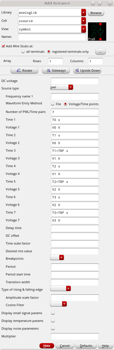

Hi Everyone
I am new to using cadence. I want to have a pulse supply voltage with four different levels of voltage (Let's say V0 V1 V2 V3). each voltage level stands for a specified period (let's say T0 T2 T2 T3) with the transition between any two levels having Fall time =TF and Rise time=TR.
So in general we should have 10 parameters (V0 V1 V2 V3 T0 T1 T2 T3 TF TR)
Any help or suggestion,
It may be done in Verilog A, but I just start learning Verilog A. any code will be helpful.
Is there a possibility to get this supply done using the Instance sources from AnalogLib
    This doesn't really need Verilog-A. A PWL source should be able to do this - I simplified it by avoiding the need for separate TF and TR parameters, as otherwise you would need the time breaks to be dependent…
    This doesn't really need Verilog-A. A PWL source should be able to do this - I simplified it by avoiding the need for separate TF and TR parameters, as otherwise you would need the time breaks to be dependent upon whether it is rising or falling. That could be done - more in a moment. However, assuming you're consolidating it into one "TRF" parameter, something like this:
    You can also make them periodic - and you can alter the number of time-voltage pairs.
    Potentially if you wanted to have a rise/fall parameter separate, then you could change (for example) T1+TRF to be T1+(V1>V0?TR:TF) - I think that would do it (I didn't test it).

    Omar Ghazal over 4 years ago in reply to Andrew Beckett
    Thank Andrew you it worked.
