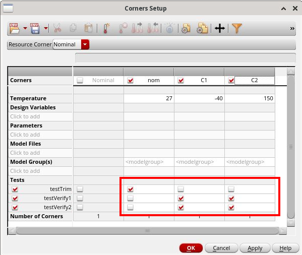

Is there a way to force that a test is only run at a certain temperature?
StephanWeber
StephanWeber over 4 years ago
in Assembler, I can set temperature either in the test as variable or in the corner tool. However, if I try both, then a conflict can arise and I got an error message.
This is fine, but my situation is more tricky:
I have a test like testTrim, which should be run at Tcal like 27C, but then I have other tests like testVerify1, testVerify2, etc. in which I want to run different T, set by corner tool.
Can I force that the T value at the test is used for testTrim (but not for the other tests)?
Or should I follow another method to enforce that testTrim runs only at 27C?
Bye Stephan

    Dear Stephan,
    you could enable/disable the tests you want to run per corner in the Corner Setup:
    Kind regards
    Matthias
