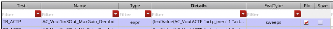

Assembler: Can't use VAR() in output expression when EvalType is sweeps, all i.e. not point
ayayla
ayayla over 3 years ago
I am trying to check some output expressions with evaltype set to sweeps. In these expressions, I have some variables from my global variables. For the run, I am sweeping some variables and some of them are fixed. I want to use one of the fixed in the output expressions but I am getting evaluation when I use VAR() as below. If I change this a fix number, I don't see an issue and everything works.
Example Output Expression:
value(dB20(VF("/Iinstimulus/DIFF_OUT")) VAR("fclk")) ~> Not working
value(dB20(VF("/Iinstimulus/DIFF_OUT")) 1e9) ~> working
Also, the working one doesn't return numeric value, I had to put another function converting wave to numeric(ymax() to be specific). Why doesn't it return numeric value like regular output expressionswith point as evaltype?

    For others having the same issue, VAR() returns a wave so that is the root-cause of the issue. Instead of VAR(), using ALIAS() solves the issue since that returns a scalar as explained in the below support page:
    support.cadence.com/.../ArticleAttachmentPortal
    So solution is using ALIAS() if variables are not being swept since it returns the first value of VAR()(kind of wrapper around VAR()).
