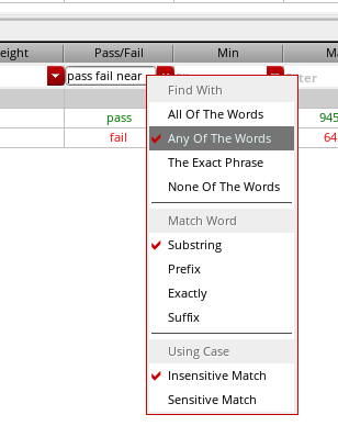

I want to see only outputs with specifications, but using a filter does not work for me.
I can use the sorting feature as workaround, and make a screenshot. But for csv export I would still have everything.
Is there any trick to suppress outputs wo. specs?
Bye Stephan
    Adding a filter on the Pass/Fail column would do this - set the filter "pass fail near" and then right mouse to pick "Any of the words":
    You can then of course save that away with a name in the "Filter" combo-box at the top of the Results pane.
  • StephanWeber
    StephanWeber over 4 years ago in reply to Andrew Beckett
    Cool, many thanks
