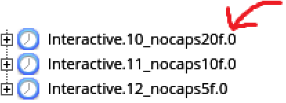

Adexl Interactive - disable appending number to already renamed job
firebolt
firebolt over 4 years ago
I rename jobs before start of the simulation using envSetVal("adexl.historyNamePrefix" "showNameHistoryForm" 'boolean t)
But, tool will still append .0 .1 .2 like numbers to it. I have to wait for run to complete & then remove them manually. Is there way to disable such suffixing numbers by envSetVal like adexl.historyNameSuffix=nil ??
    You can change this behaviour with: envSetVal("adexl.historyNamePrefix" "initiallyAddHistoryNameUniquifier" 'boolean nil) That will stop the numerical suffix being added on the end, unless the history…
    That will stop the numerical suffix being added on the end, unless the history already exists with that name.

    firebolt over 4 years ago in reply to Andrew Beckett
    Thanks Andrew. It works.
