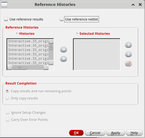

Adexl Reference Netlist - new runs still point to old netlist even with Reference Netlist disabled
firebolt
firebolt over 4 years ago
I used reference netlist only (not results) for editing netlist and fired few runs. Later I disabled it, clearned Interactive name and fired new runs. But, the new runs are still pointing to old reference netlist. I tried closing virtuoso & reopening it. Nothing works. Only workaround I have now is, copy expected new netlist to old interactive path and use it. Any help here?
    I can't really see how that could happen and I'm not aware of this being an issue. Please contact customer support.
