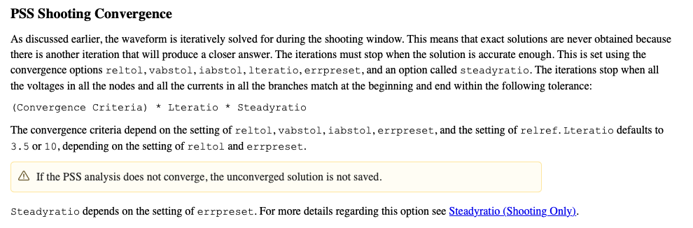

    From Andrew's comment StephanWeber, you probably know this already for which I apologize. However, for others who might view this post, the convergence criteria and the parameters that impact PSS convergence are provided in the RF Analysis Assembler/Explorer User Guide (21.1) at URL:
    https://support.cadence.com/apex/techpubDocViewerPage?path=spectreRFinExplorer/spectreRFinExplorer21.1/Chap4.html#pss_analysis
    where it states:
    Hence, you might consider relaxing your simulation accuracy requirements "very carefully" as a possible means of reducing the number of iterations to achieve PSS convergence. However, achieving your goal may result in simulation errors that are not tolerable in your application.
