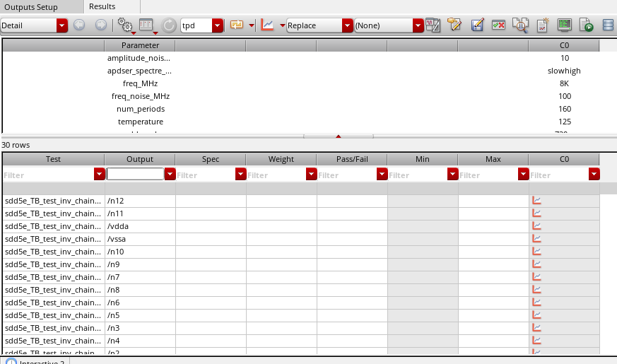

    Figure 1 and Figure 2 show an example for an Assember session where I filter my output results to only include propagation time measurements that I define as starting with the string "tpd".

    Figure 1: Unfiltered Results tab
    Figure 2 Filtered Results tab by propagation delay outputs containing string  "tpd"
