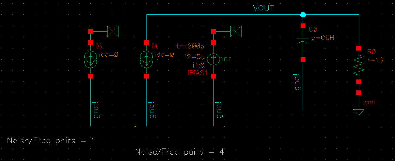

The picture below is the setup I am using.
I am trying to find the rms noise at VOUT from transient noise simulation and got the same result regardless of the number of Noise/Pair.
From here, I conclude they are white noise. If it is so, why is it possible to have multiple pairs? What is the purpose?
If there is any reference about this, I would like to know.
I cannot find any information in Spectre/Analog Library Reference.

    The idc I used, I use the same schematic, just connected/disconnected them:
    I4 --> 4 Noise/Freq pairs
    I6 --> 1 Noise/Freq pairs
    Here is the netlist.

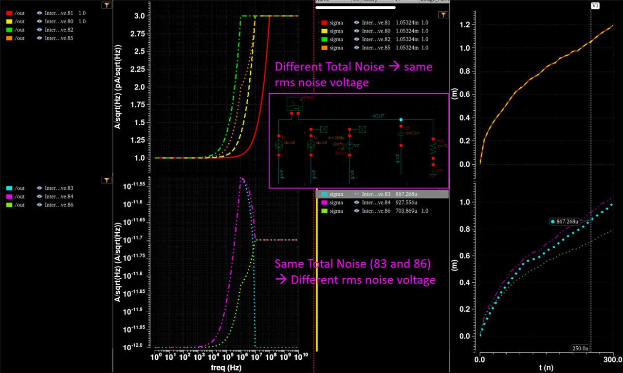

    The picture below summarizes the result.
    There are some other things which I do not understand here.
    But here is the first one.
    In the top left, 4 simulations have different total noise, but they have exactly the same rms noise voltage.
    From the computational/software point of view, is this valid?
    If there is any reference about this kind of simulation, I would also like to know.

    I was aware already when I post my other reply yesterday regarding the noise level at other frequency.

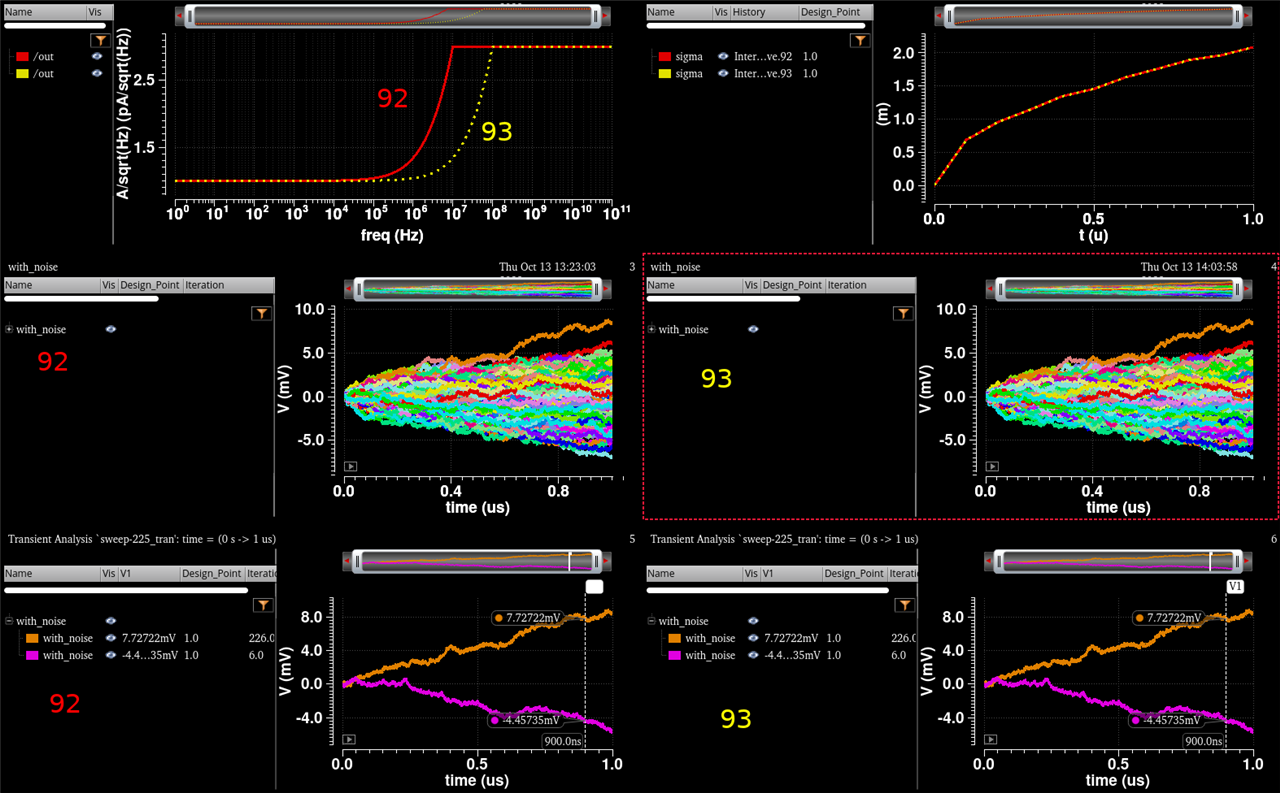

    Regarding the simulation time, I made new simulation summarized in the picture below.
    In the transient analysis setup, I used Fmax=100GHz.
    You can see that the VOUT at the transient result are exactly the same even though the noise spectrum are different.
    From software point of view, do you think it is valid?
    Is there anything that i can try?
