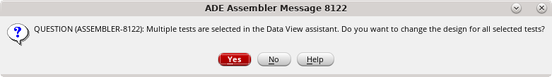

    You can do this by selecting the first test in the Tests section of the Data View assistant, and then shift-clicking the last test name (so all test names you want to change will be highlighted). You can deselect any you don't want to change by ctrl-clicking the test name. Then right mouse->Design and specify the new design name (lib/cell/view name). When you Ok this form, you'll get:
    Clicking Yes will change the design for all the tests.
