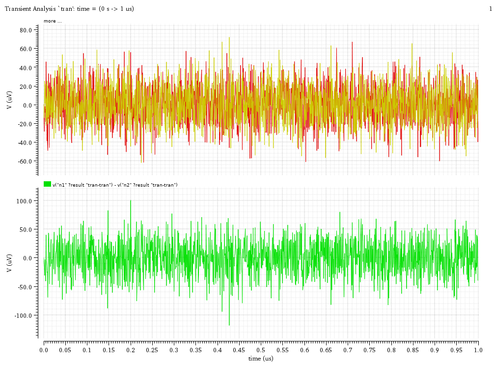

I wanted to do phased array front-end simulation and needed Mutiple ports with uncorrelated noise, however in my tran noise sim, I see the difference between two nets are zero which means they have the same noise which is not the case in phased array systems. Any suggestion to address this issue?

    I didn't believe this, so I just tried it and don't see this behaviour (I can't really see how the noise of the two nodes - I assume you mean the top end of each resistor - can be the same). Are you sure you've actually enabled transient noise?
    What does your input.scs look like?
    Here's my test (a handwritten netlist, but should be similar):
    port0 (n1 0) port
    r0 (n1 0) resistor r=50
    port1 (n2 0) port
    r1 (n2 0) resistor r=50
    tran tran stop=1u noisefmax=1G
    and here's the results - the top two traces are n1 and n2, and the bottom is the difference:

    Thanks, here is input.scs, but you are right, I probably made a mistake on plotting, now it works as expected.
