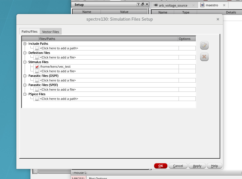

    Hmm, I tried a trivial example, and failed.  I assumed that there's no actual voltage source, just a pin to which the vectors are assigned. I copied your VEC list and got a syntax error for column 1?
    Andrew Beckett over 4 years ago in reply to kenc184
    Not a good idea to keep editing your response - if I'd not have looked, I'd have assumed all was OK because the email notifier is only sent on the initial post (i.e. not including any edits).
    You don't need a source - just a wire (or a pin) and a name to reference. It's covered in the Spectre User Guide here: https://support.cadence.com/apex/techpubDocViewerPage?path=spectreuser/spectreuser21.1/appD.html#pgfId-52472
    How did you reference the file? Please post a screen shot of the Simulation Files form showing the reference.
    Also, the full error message rather than just the last part of the line - ideally as text rather than a screenshot.

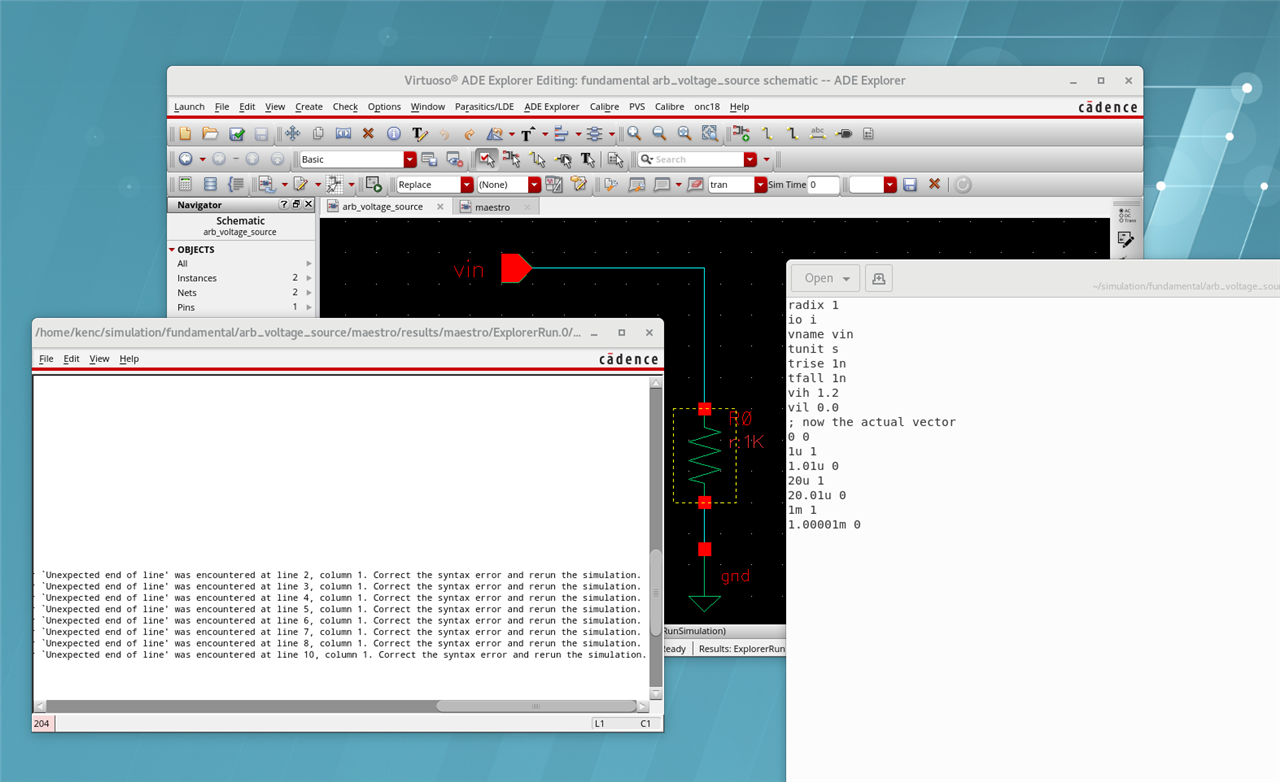

    Oops, sorry about that.  Requested info, plus netlist below.
    Error found by spectre during circuit read-in.
        ERROR (SFE-874): "/home/kenc/simulation/fundamental/arb_voltage_source/maestro/results/maestro/ExplorerRun.0/1/fundamental_arb_voltage_source_1/netlist/stimuli/vec_test" 2: Cannot run the simulation because syntax error `Unexpected end of line' was encountered at line 3, column 1. Correct the syntax error and rerun the simulation.

    And the netlist:
    It was flagged as spam because of the repeated text (obviously is not spam in this case, but it’s a common trait). You didn’t appeal the other attempts so I only approved this one.
    Anyway, the problem is that you’ve specified it as a stimulus file, which is not the right place. As I mentioned before, you need to use the Vector Files tab and specify it as a vector file on that page (not VCD - it’s a vector file).
    By including it as a stimulus file it would be expected to be in spectre netlist syntax, which is a different language.

    kenc184 over 4 years ago in reply to Andrew Beckett
    Thanks again Andrew, it works perfectly.
    I wish I had asked this question 10 years ago, it would've saved me a lot of Vbit and vpwl grief.
