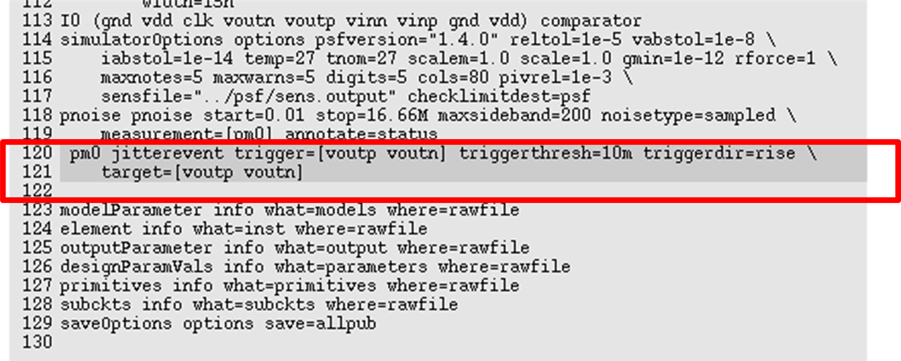

I'm currently designing a dynamic comparator and would like to get the input refered noise by jitter in the pnoise simulation.
And this is my pnoise simulation setup.
It turns out the error SFE-23, seems like pm0 is not in the model library, so I check my input.scs file to figure out what is pm0.
But I still have no idea about pm0, do I miss something in my model library?
If so, is anyway to solve it?
    Your Spectre version is way too old. That Spectre version is from 2015 - and the way that jitter is handled in the simulator has been revamped in the meantime (I'm slightly surprised because normally the UI adapts to only show the newer capabilities based on the version in use). I can't remember quite when it changed, but you should use more recent SPECTRE version (the release stream changed names many years ago too). Since we've had 6 major versions since the version you're using, I'd suggest you move to using SPECTRE21.1 (or SPECTRE20.1, but you might as well use the latest).
