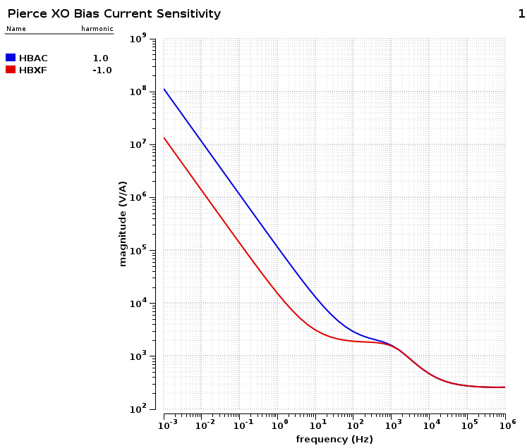

Now it would actually be nice to use HBXF, as with one simulation run I could derive other sensitivities of interest such as supply pushing and tuning gain. I'm using:
hbxf ( vosc VSS ) hbxf sweeptype=relative relharmvec=[1] start=1m stop=1M dec=5 sidevec=[-1] annotate=status
Comparing this sweep (harmonic -1) to the HBAC result as above I see:
So at AC frequencies in the kHz region, the two simulations match. But at lower frequencies, they deviate by approximately an order of magnitude. To me it is not clear why this is the case; so far I've thought of the XF/HBXF/PXF analyses simply as "reversed" AC/HBAC/PAC analyses that should give exactly the same result if one picks the correct transfer function. Obviously I'm missing something here.
Any help to get me back on track? Thanks very much for your input.

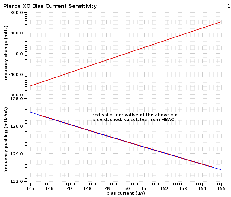

    For post-processing in ViVa, I'm using the commands below. First absolute frequency change:
    harmonicFreq(v("/vosc" ?result "hb_fd") 1 ) - value(harmonicFreq(v("/vosc" ?result "hb_fd") 1 ) 150u )
    Then the derivative of that to calculate the supply pushing:
    lshift(deriv(harmonicFreq(v("/vosc" ?result "hb_fd") 1 )) 0.5u )
    Then the calculation based on HBAC (in my first post I've just used one sideband and doubled it's magnitude, here I'm summing the -1 and +1 sideband which is physically more correct I think):
    (value(leafValue( mag(v("/vosc" ?result "hbac")) "harmonic" -1 ) 1m ) + value(leafValue( mag(v("/vosc" ?result "hbac")) "harmonic" 1 ) 1m ))*1m/harmonic(mag(v("/vosc" ?result "hb_fd")) 1 )
    This gives the following plot:

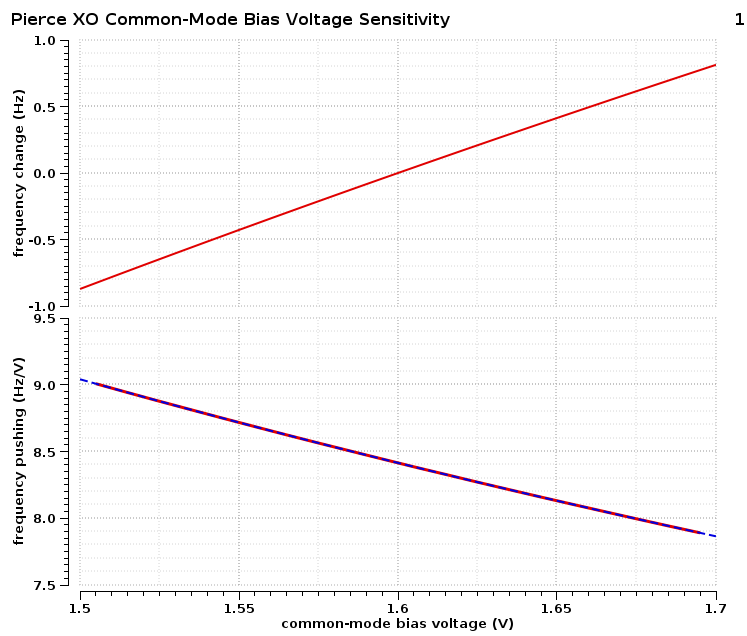

    As you can see, the direct method and the HBAC-based calculation match exactly. I can repeat this procedure for the 'VVCM' source and get matching results too:
    So this approach seems to be correct.

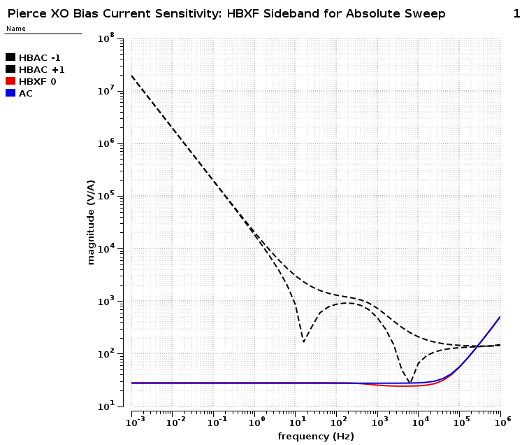

    Now for HBXF I'm using:
    hbxf ( vosc VSS ) hbxf sweeptype=relative relharmvec=[1] \
        start=1m stop=1M dec=5 maxsideband=2 freqaxis=out annotate=status
    But neither the shape nor the absolute magnitude of the resulting sidebands match to the HBAC (HBXF results are shifted in frequency such that the x-axis matches that of the HBAC):
    If I repeat for the 'VVCM' source, even the ratios between HBXF and HBAC change:
    So to me it seems that my previous understanding that the HBXF is imply a 'reversed' HBAC is not correct.
    Any ideas how to explain this or suggestions on how to make these sensitivity simulations with HBXF? Thanks very much.

    I don't have a lot of experience with hb (I mostly use pss), but I suggest you try sweeptype=absolute and freqaxis=in in your hbxf analysis, just like in your hbac analysis.

    There actually is frequency conversion involved; I'm interested in how baseband noise/interference/drift affects the frequency/phase of the oscillator. The source of the noise is at or near DC, the observed effect converted up as sideband around the fundamental frequency (and harmonics) of the oscillator.
    I've already played quite a bit with the 'sweeptype' and 'freqaxis' parameters before posting here and I believe my settings are correct. 'freqaxis' affects the x-axis of the output only. It's convenient to use 'in' for HBAC as this maps all sidebands to baseband (1 mHz to 1 MHz in my case). For HBXF, there's no setting that achieves this but 'out' at least maps all sidebands to the fundamental frequency (50 MHz plus 1 mHz to 1 MHz in my case). Other settings for these analyses map the sidebands to different frequencies os are inconvenient for plotting. And again: the y-axis values are not affected, so this setting cannot explain the difference between HBAC and HBXF.
    'sweeptype' essentially determines how the sidebands are numbered. For HBAC, the simulator analysis the path from current source to oscillator output, so the sweep is at the absolute baseband frequency. For HBXF, the simulator looks 'backward' from the oscillator output to the current source. The sweep is thus relative to the carrier. Using the 'absolute' setting for HBXF requires an inconvenient sweep definition for a log sweep (one has to manually set each value using 'values=[50.00001M 50.0001M 50.001M]' etc.) and as a result just has differently numbered sidebands (if I remember correctly, sideband -1 becomes 0, -2 becomes -1, et.c). Again the y-axis values remain unchanged, so this does not help to explain the difference between HBAC and HBXF.
    If I have time I'll see if I can run some PAC/PXF sims on the circuit. As the startup of the oscillator is slow, using PSS is not a practical solution here, though.

    Have you ever tried running the hbxf analysis with sweeptype=absolute and the original logarithmic sweep? In the documentation of the hbxf analysis, sweeptype is defined as follows (emphasis is mine):
    sweeptype=unspecified
    Specifies if the sweep frequency range is the absolute frequency of input or if it is relative to the port harmonics. When the unspecified value is used, Spectre RF sweeps using relative when autonomous simulation is performed or when the analysis is PSP; for other cases Spectre RF sweeps the absolute value of the input. Possible values are absolute, relative, and unspecified.
  • sgcad
    sgcad over 3 years ago in reply to Frank Wiedmann
    Yes, I think I've done an exhaustive search on all possible combinations. sweeptype=absolute for the HBXF gives the baseband-to-baseband transfer function, which is--apart from minor shifts from the large-signal operation--equivalent to a regular AC analysis. The following plot illustrates this; other HBXF sidebands show negligible response so are omitted.
  • Frank Wiedmann
    Frank Wiedmann over 3 years ago in reply to sgcad
    It's strange that all the other HBXF sidebands show negligible response, I would have expected similar results as in the HBAC sidebands if all parameters are the same. I suggest that you contact Cadence Customer Support to sort this out.
