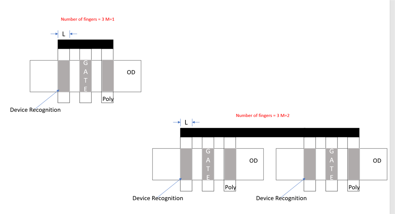

PVS LVS 'number of fingers' and 'm-factor' calculation
Mark G H
Mark G H over 3 years ago
Is there a way to find number of fingers / fold/ finger count and m-factor together in a multi-finger device in PVS LVS using the set up attached?
