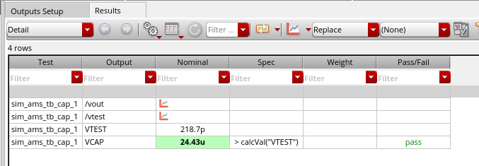

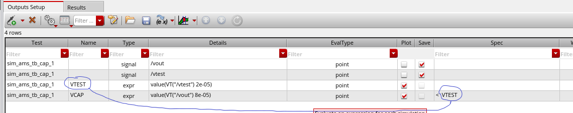

Hi all, I have a question about "Defining Specifications for an Output"
If in the spec column I write VTEST which is bound to an ocean expression the evaluation is not working and give the following error
"*Error eval unbounded variable"
If I write the ocean expression it self it works.
How can I fix this?
I can not put constant in the spec column because in the real circuit the spec is changing and need to be taken from another output expression.
    As far as I know (and I've not checked this recently), this should work if you use calcVal("VTEST") in the spec. The documentation still only talks about using variables in the specs (which means VAR()), but doesn't really give much detail and it was supposed to have been updated to also show that calcVal (at least the single-argument version of calcVal to get an output from the same test) should work. There were some limitations (CCR 1442710) but I've not checked recently to see whether they are still there or not.

    Shimon4773 over 3 years ago in reply to Andrew Beckett
    It works, thank you very much it is a real saver.
