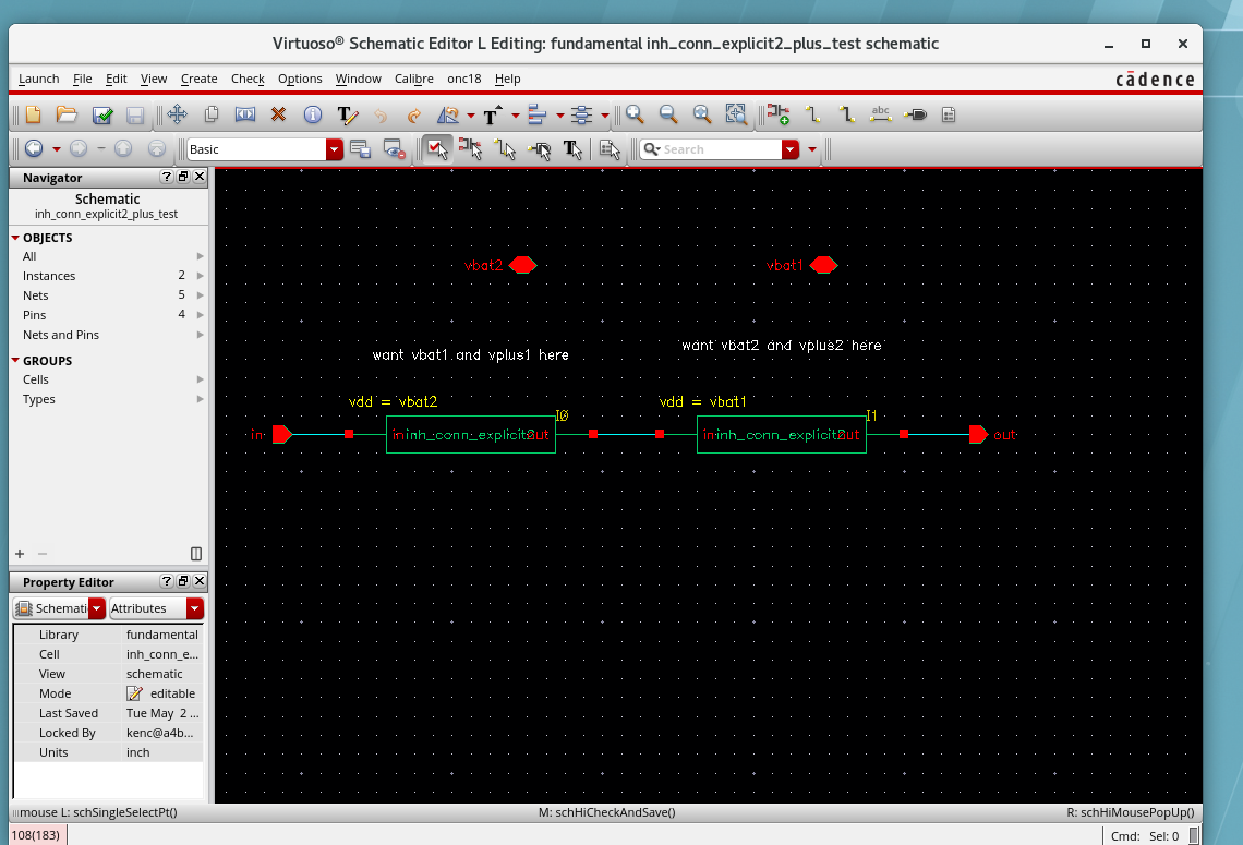

    I started off with inherited connections, but ended up removing them because I could not figure out how to handle cells with two (or more) inherited connections with the same property name (vdd in the case of the pdk cells).  I have many cells with multiple vdd supplies. I changed to globals, which solved that issue, but now that is a problem!

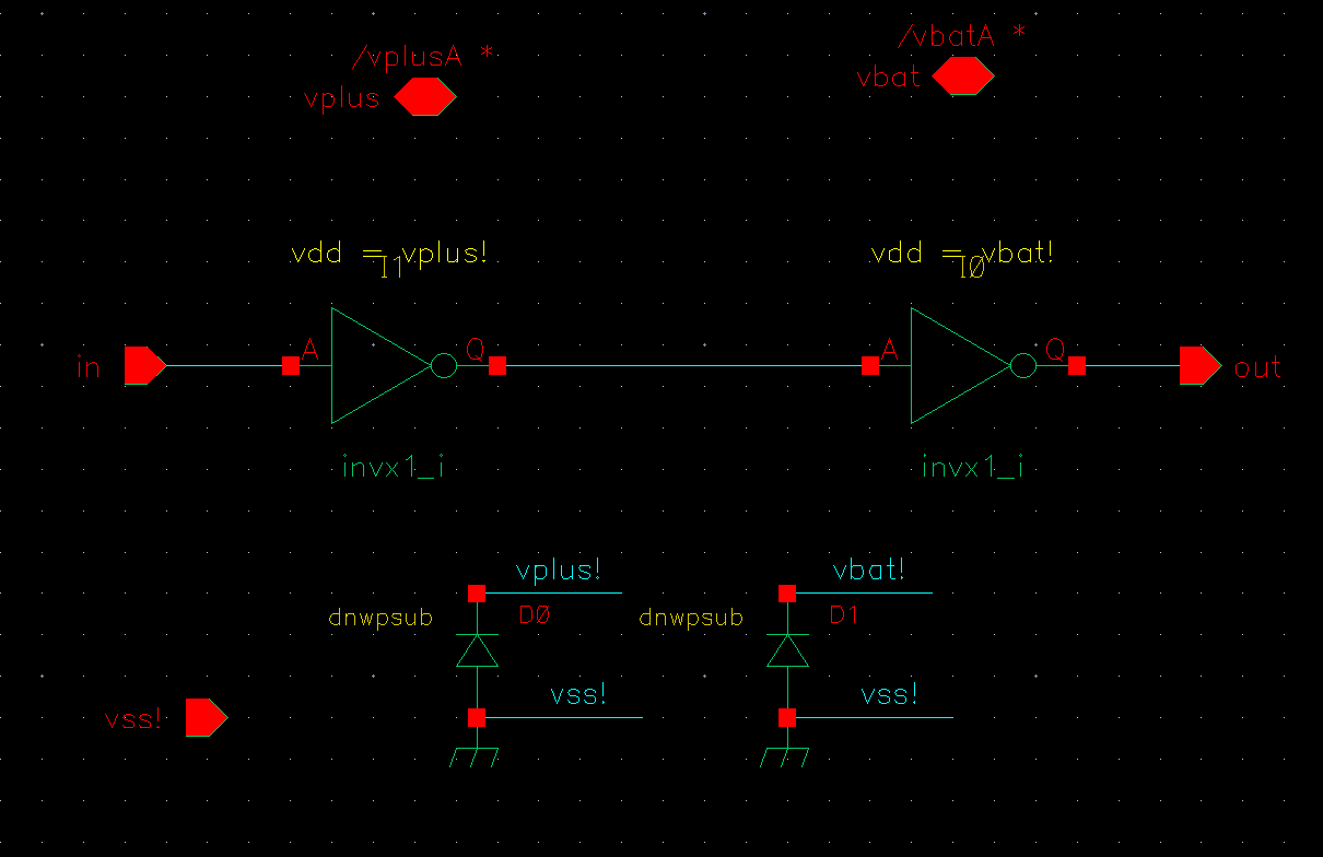

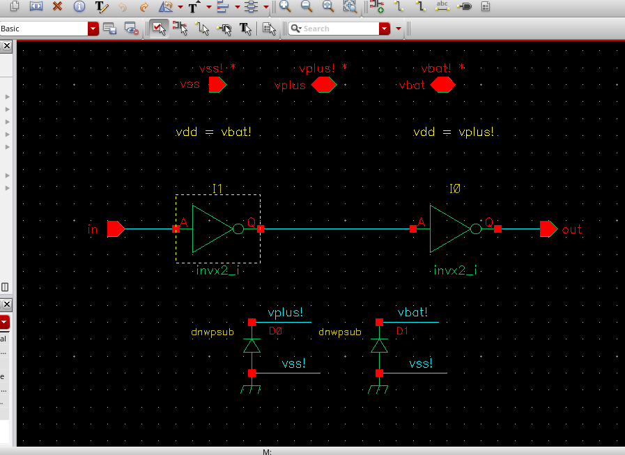

    I put together this  trivial example cell made from two pdk inverters. The pdk inverters use vdd as the property name for the plus supply. The netset is shown in yellow.
    So far, so good. The left inv assumes vdd=vbat!, the right one vplus as expected.

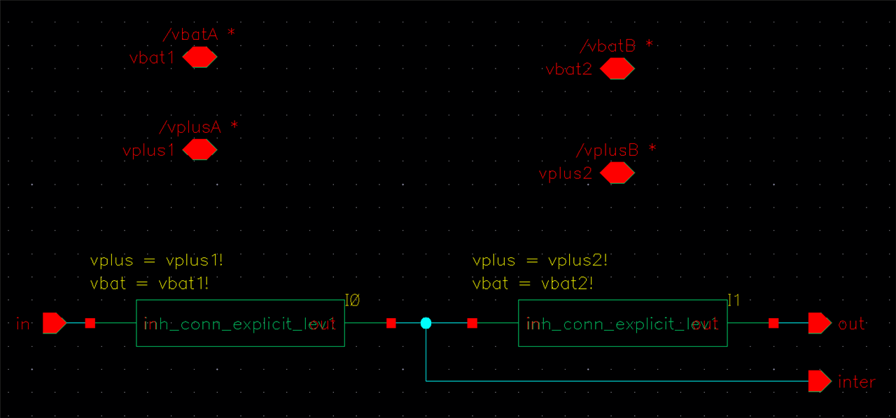

    But at the next level I want vbat1 and vplus1 for one cell, and vbat2, vplus2 for the other.
    But, of course,  both vplus and vbat assume vbat1 for the right "cell", and vbat2 for the left cell.  I can't add a second netset with the same property name.
    Do I have to edit the pdk cells (if I can) to give the individual inverters (in this example) different property names?

    Andrew Beckett over 3 years ago in reply to kenc184
    There's no "bang" in your pins - the only "bang" is in the default value of a net expression. That's because the default has to be global - if you don't override the property then it needs to be able to connect to it somehow - hence making the default a global net.
    The issue in your schematic is that you have the pins on one net, and the inherited connection overrides on another net. When you create an explicit pin called vbat2 with a net expression with a default of vbat2!, the local net in schematic needs to be called vbat2! (that doesn't make it global - because of the presence of the inherited connection, all nets called vbat2! in that schematic are connected and overridden by the property).
    The easiest way to do what you want is to select the instance and then use Edit→Net Expression→Available Properties. Select one of the properties and choose "Convert to inherited pin". You can then give the pin name, property and default (which should auto-populate) and it will then set the property on the instance to (say) [@vbat2:%:vbat2!] - so it will directly connect the vbat property on the instance to the new inherited net at this level.
    Or you could use the "Override with specific net" and set that net to vbat2! and then create pins yourself as you've done.

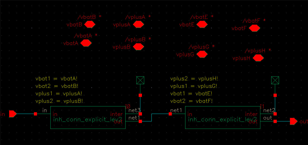

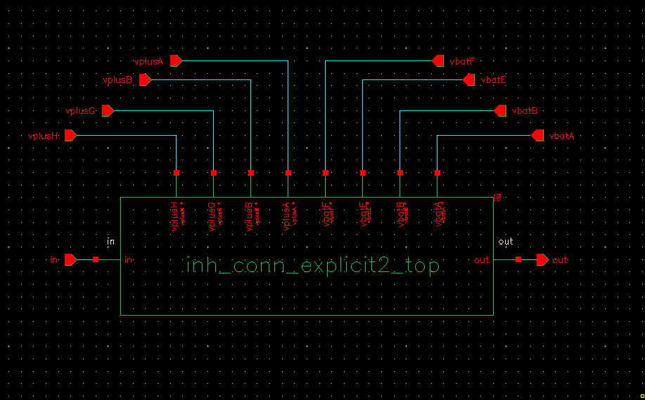

    I am still confused (apologies for being so thick) about the necessity for assigning a bang to the netset property.  I have put together a more readable example of multi level inherited connection example which achieves what I want, Each inverter at the bottom level maps to each of the top level non-banged vplus and vbat supplies.
    But I am curious why every default net couldn't be assigned to the same default - e.g. vbat! rather than e.g.  vbatA!, vbat2! etc which appeared to be necessary.
    This setup - with netsets mapped to bangs - appeared to be the only one which achieved my goal.   I could not get netset of: e.g. vbat2=vbatB (no bang) to work no matter how I configured the explicit pin, an implicit wire always resulted.

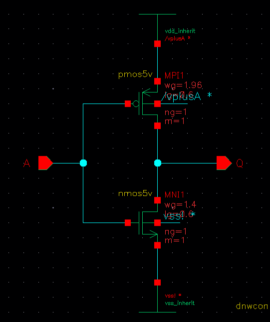

    The PDK cell using the analoglib vdd_inherit. As you can see it is reflecting the top level unbanged supply vplusA

    Top level with eight non banged power nets

    The net in a schematic which has a net expression on it (or on the terminal) will always be locally called blah! (i.e. with a bang) because the net name in the schematic when you're editing it will reflect the global (default) net name. If you have a netSet of vbat2=vbatB then that means it is bound to a local net called vbatB then that will be distinct from the default net of an explicit pin with a net expression where the default was vbatB! (they are different nets).
    You can't have the same net as the default for two or more net expressions in the same schematic. That's because the actual net in the schematic would be the same for both of them - say you had vbat1 with a default of vbat! and vbat2 with a default of vbat! - anything on the net vbat! in the schematic is connected - and so you can't override vbat1 to be one thing and vbat2 to be something else at a higher level netSet - because they are actually connected in the schematic and so can't be two different things.
