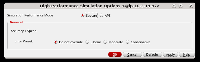

I'm looking for a way to change the default simulator from APS to Spectre:
The dialog is from the ADE L environment (I know this is obsolete, but that's what we're still using for now), menu "setup -> High Performance Simulation". That's in Virtuoso IC6.1.8-64b.500.29.
Thanks very much for your input!

    This may be helpful, envSetVal("spectre.turboOpts" "uniMode"                  'string  "Spectre")

    Perfect, thanks very much!
