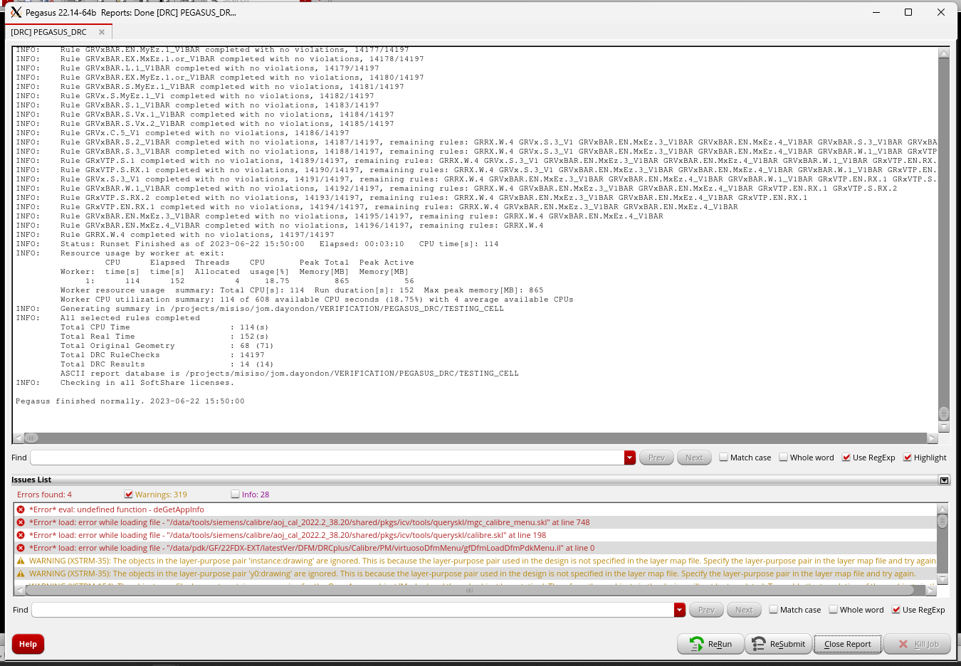

Hi. I am having trouble with my DRC runs in Pegasus 22.14. After running the DRC, the Results Viewer displays empty. And no DRC error reports are even visible.
There is a message that says read error on the Rdb file. Here are some images of the DRC run (Reports & Results Viewer):
