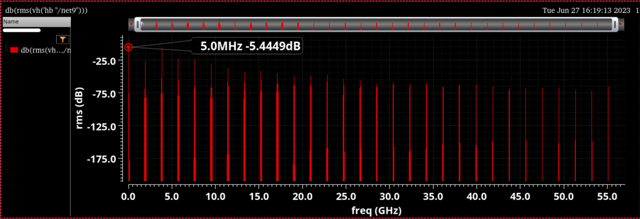

Hello community,
I want to get the Y-axis value at frequency of 5 MHz (in this case -5.44 dB) to the expression editor or export to a table, how can I do that? I couldn't find any expression that is capable of doing that.
Thanks in advance!
    You need to use the harmonic function to find the harmonic combination you want - for example:
    db(harmonic(rms(vh('hb "/out1")) list(4 5)))
    where the frequency is 4*fund1+5*fund2. You can get the indices using:
    harmonicFreqList(?result 'hb_mt_fi)
    in the CIW, assuming you're using a single simulation of a multi-tone hb (sounds like it from the title/description).
