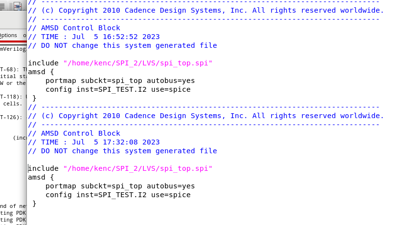

    Ah interesting, there is a file (I was initially looking for a statement using grep) called spiceCB.scs.  It appears to be auto generated, and also appears to be concatenating the same information presumably after every run.   So, the first run it generates the appropriate stuff, then on the second run instead of overwriting it, or leaving it alone, it adds to it thus causing the "multiple specifications".
    How do I prevent this behavior?

    I found a couple of very old reports of this which were fixed - one back in IC615 and one in early IC617, but nothing recent. How exactly are you running the simulation? Is this from ADE? Is it command-line? How are you referencing the SPICE block for "spi_top.scs"?
    Probably it would be best to handle this via customer support, to be honest.
