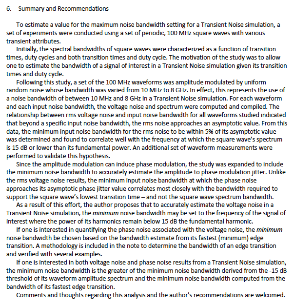

    I realize it has been some time since you asked your question concerning the motivation for Cadence recommending the noisefmax parameter as 40 times the clock frequency of the ADC. However, the question concerning the appropriate choice for the maximum noise frequency in a Transient Noise simulation is relatively common and is seen often in the Cadence Forums. As a result, I have attempted to study the issue a bit more and have come up with some guidelines for choosing the maximum and minimum noise frequencies based on the relevant signal's properties. I considered a Transient Noise simulation where one if primarily interested in voltage noise and a Transient Noise simulation where one's concern is in phase noise or both voltage noise and phase noise. I've placed the note at URL:
    1drv.ms/.../s!AnM-GsAEZPoSry7qIOYgZd02_-C0
    and have attached its summary and conclusion section below to save you or anyone with an interest some time if you are still interested in the topic.
    Shawn
    Section 6 of note at URL:
