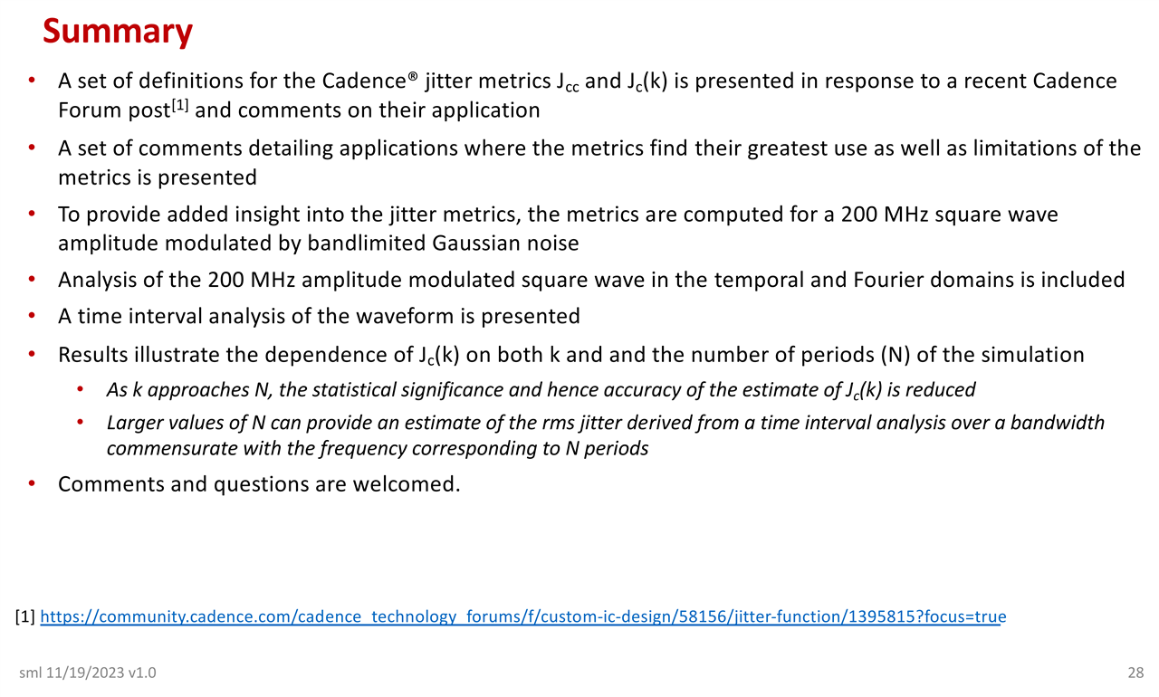

    Hi Shawn, is it possible to get a similar document for Jc and Jcc? I want to understand how k factor effect the jitter measurement.
    Context: I'm observing that if I keep on increasing the k factor in my calculator jitter keeps on increasing till 1000e3 cycles (beat frequency is 500kHz) and then becomes constant. Does it indicate a long-term jitter and requires large number of cycles to give constant STDeviation? Or my understanding is totally wrong.

    Dear HSDROP,
    I took some time to assemble my understanding of the Cadence Jcc and Jc(k) definitions. I also thought an example waveform might help provide some added insight into the jitter metrics. Finally, I made an attempt to answer your question as to how the value of Jc(k) behaves as k increases and approaches the number of periods (N) of the simulation. The notes is at:
    I am unable to include the actual link as it will cause my response to be classified as spam. However, if you are interested in reviewing the note, you can copy and paste the following into your browser after manually typing the prefix.
    1drv.ms/b/
    s!AnM-GsAEZPoSr1ymmxF5WYE75-j1?e=fwLQ3R
    To save you (or anyone with an interest), I've attached the summary page 28 from the note as Figure 1.
    I hope this is useful and helps address your question HSDROP.
    Shawn
    Figure 1
    page 28 of "Definitions of Cadence® Cycle-to-cycle Jitter Metrics Jc (k) and Jcc and Examples"
