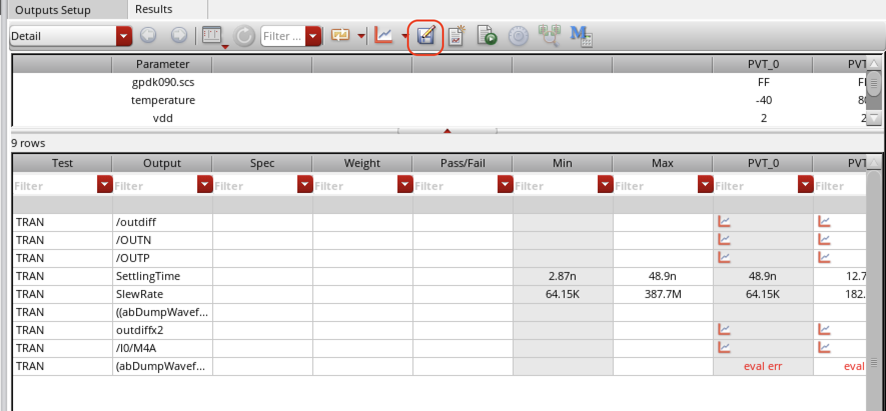

    Andrew Beckett over 3 years ago in reply to Andrew Beckett +1
    Tools→Export Data can be used (even when there is only a single run). Andrew
    Press this icon.
    Oh, hang on - that icon is not there if you didn't sweep anything. I'll check later and get back to you.
