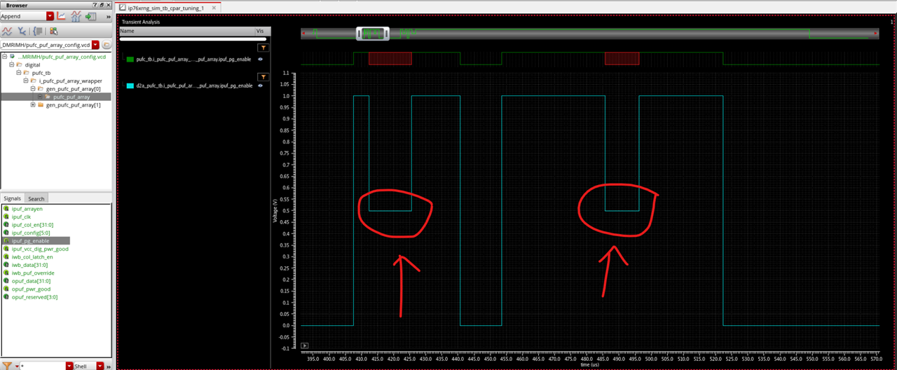

I am trying to convert a digital VCD signal into an analog signal. I then go to Menu -> Measurements -> Digital To Analog -> and select "0" as X value. (shown in image)
However, the tool ignores the "X" value and always outputs 0.5 as value for X. I tried using vhi, vlo, as values for "X", and I get the same result as 0.5 (shown in image below, first is the digital vcd, second is the analog converted signal). Please help.

    Did you try entering your desired value of 0 as the default value for ViVA in your .cdsenv file?
    viva.trace dToAHiVoltage string "1.0"
    viva.trace dToALoVoltage string "0.0"
    viva.trace dToAXVoltage string "0.0"
    I believe you will need to restart Virtuoso to see any change it effects.
    Shawn
    Andrew Beckett over 1 year ago in reply to ShawnLogan
    This is nothing to do with a .cdsenv setting. There just seems to be a bug - the "X" setting - either on the Digital to Analog form, or using the awvDigital2Analog function, simply does not work. The documentation describes that it can be a number, or vprev, or some function of vhi/vlo, but it always seems to use (vhi+vlo)/2 regardless of what is passed. I assume this broke at some point, but it's certainly broken in IC6.1.8 ISR34.
    I couldn't find a report of this, so I filed CCR 2893484 to address this. You might want to contact customer support and request a duplicate is filed on your behalf so that you can track this.
