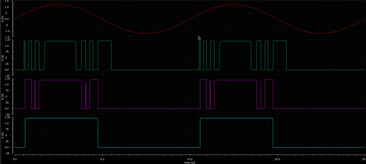

Hello everyone,
I need to test a 3 bit  Flash ADC in ADE Explorer. For an analog input (such as a sinewave) it gives in output a digital bit stream. How can I process this signal/data? I have to obtain the typical staircase signal in order to measure INL/DNL.
how to get this staircase signal?
