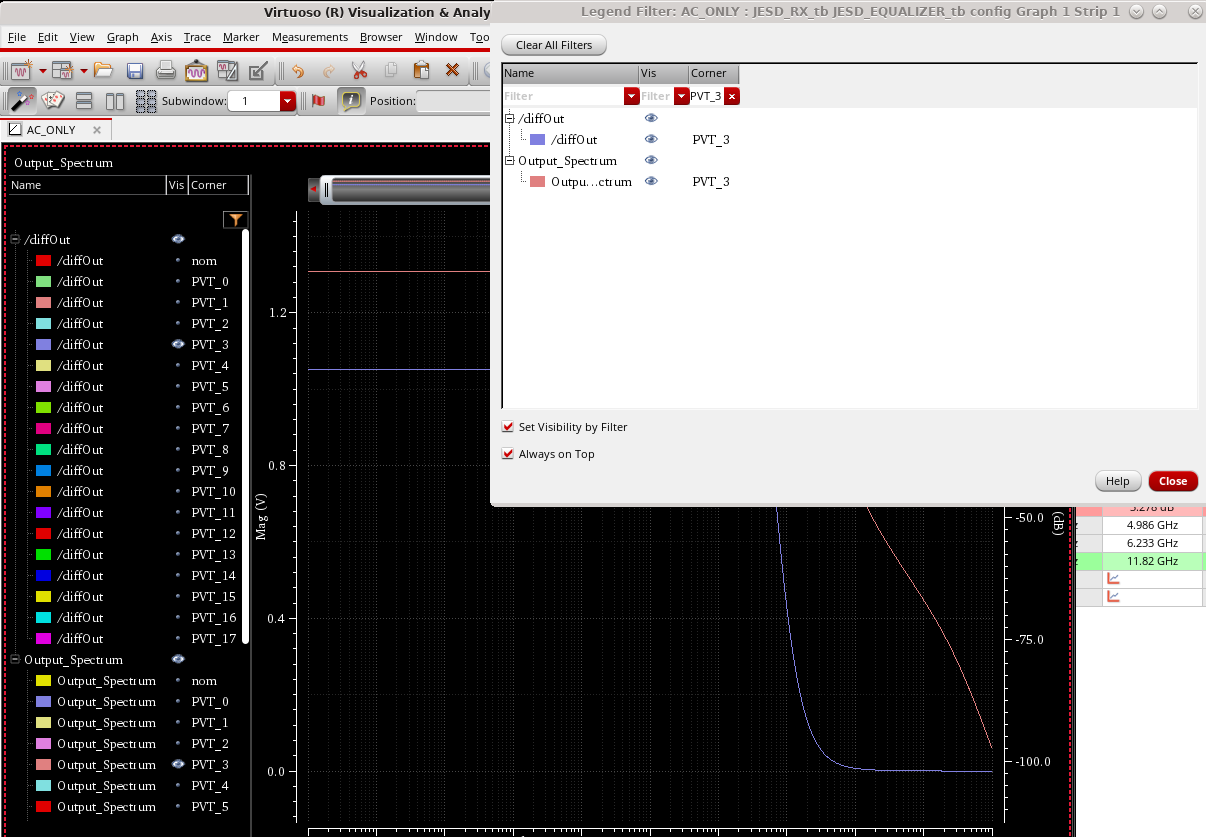

I'm wondering if there is an easy way to select a corner to display for all traces in ViVa. By default all corners are shown in a plotting window and it would be nice to compare multiple traces by corner without having to select each one individually. I've searched the documentation and I don't see anything like this there.
    Andrew Beckett over 2 years ago
    You could use the legend filter:
    Which brings up this:
    and then you can use the filters in the columns at the top to alter visibility:
    Other ways would be to use Graph→Filter by Sweep Var, or to use Window→Assistants→Customize Trace Groups to change colors, strips etc on various factors. However, I think the legend filter above is the closest to what you describe.

    Exactly what I was looking for, thanks.
