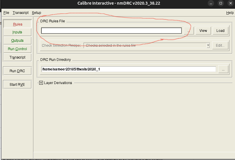

FIles for nmDRC in calibre for gpdk180nm ?
Sameerpy
Sameerpy over 2 years ago
Hi ,
I tried to run nmDRC in calibre but don't know which file to be included in DRC rules files section as a valid DRC file. I already take a look in directory gpdk180nm  but not able to know which DRC file to be included in this section.
Thank in advance.
    Andrew Beckett over 2 years ago
    Given that Calibre is a tool from Siemens EDA (not Cadence), the various generic PDK releases do not include Calibre rules (we do not have access to the tool to write or validate the rule files).
    Support is there (depending on the PDK) for Assura and/or PVS, two of the Cadence physical verification tools.
