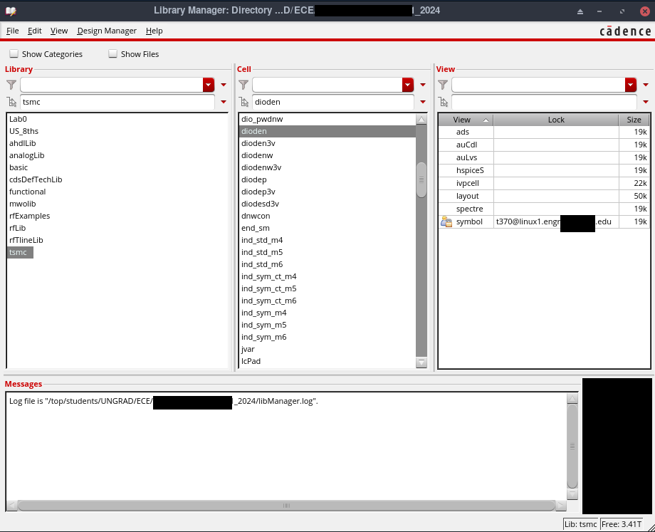

    I checked it out, there's definitely a problem. Our university recently switched over from Cadence 2018 to Cadence 2024 and the TA's don't seem to know where the files are and they both have different ways of linking to the files. I've secured a folder full of what look to be model files, ans a .scs file. But getting them to work in my project has been a problem.
    The weird thing is I can use the models in my project, but I cant get them to work properly. For example, the diode (dioden / "ndio") model doesn't behave in an exponential manner and has no reverse breakdown.
    I'm doing more research into how the filesystem in cadence works in my very little free time, but you wouldn't happen to know a good resource would you?

    I've made some progress on my own in the meantime. I have a local copy of the library, I have used the Library Path Editor to make sure that the proper path has been added to CDS.lib, and I have used the Library Manager to confirm that Virtuoso is at least reading information from the library. (sorry, the TA's and professors call it Cadence so that's what I thought it was called)
    Below is a view of my Library Manager showing that Virtuoso can see files pertaining to the cell in question. Unfortunately, the cell / component (doden) is not behaving as it should according to the Lab. when tested under reverse bias, it does not breakdown. However, I think exceeds the question I originally posted.
