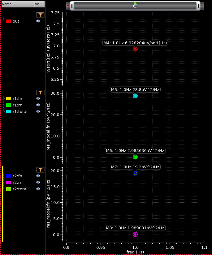

I have tried replicating the setup described in a previous post (here), with the proposed solution.
The MDL measurements return a value of 0 for all exported result but the first.
Using Viva I can actually see the correct value for each contribution.
I am using :
- Spectre 23.1.0.538.isr10
- Viva IC23.1-64b.ISR8.40
What should I do differently?
Thanks!

**** test.measure ****
Measurement Name   :  noi_test
Analysis Type      :  noise
noi_total             =  6.9282e-06
r1_flicker            =  0
r1_thermal            =  0
r1_total              =  0
r2_flicker            =  0
r2_thermal            =  0
r2_total              =  0
