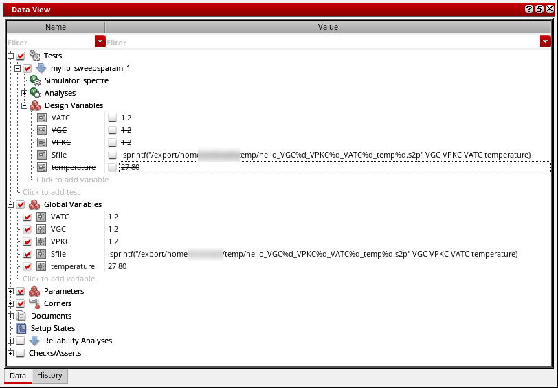

I have been dealing with this the whole day, trying to save a sweep of S parameters in Assembler
I created a global variable called Sfile, defined as:
Sfile   sprintf(nil "/home/ma045619/simulation/Spar/hello_VGC%d_VPKC%d_VATC%d_temp%d.s4p" VGC VPKC VATC temperature)
The variables are just control signal values.
For sprintf, syntax seems correct.
Directory exists,
S parameter simulation has the output file as:
VAR("Sfile")
But the simulator complains about the first  forward slash character "/"
Cannot run the simulation because syntax error `Unexpected operator "/"' was encountered at line 11, column 10
I tried all the typical C syntax variations but nothing seems to work.
The solution should be simple, but I guess it is some SKILL specific syntax.
  • IM202411276820
    IM202411276820 over 1 year ago
    It seems the path must be in double quotes " ", I tried lsprintf with quotes but Virtuoso just hangs and crashes....
    lsprintf("\"/home/ma045619/simulation/Spar/hello_VGC%d_VPKC%d_VATC%d_temp%d.s4p\""  VGC VPKC VATC temperature)
    Andrew Beckett over 1 year ago in reply to IM202411276820
    Which version of Virtuoso are you using? I just tried this in IC23.1 ISR13 and it worked fine (with either design variables or global variables). Here's my setup (I didn't need extra quotation marks; I used lsprintf instead of sprintf just to avoid the nil argument):
  • IM202411276820
    IM202411276820 over 1 year ago in reply to Andrew Beckett
    Yes it is version related, I was using 500.34, and upgraded to 500.36 and later to Virtuoso Studio.
    My data collection is now working properly, but I was truly stuck thinking it was a syntax.
