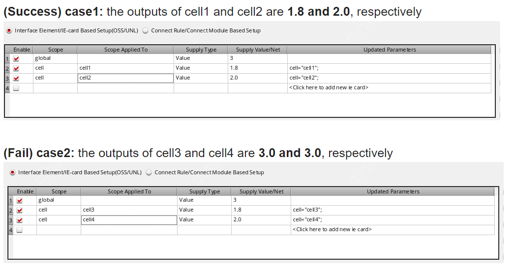

IE Card configuration only makes effect on hierarchy of level 1, if hierarchy level is over 2, IE Card configuration would behave unexpectedly
  1. CASE1, there are 2 instances in TB, I0(cell1) and I1(cell2), simulator successfully convert logic High to 1.8 and 2.0;
  2. CASE2, there is 1 instance in TB, I0, and 2 instances inside the I0, I0/I0(cell3) and I0/I1(cell4), In this case, the simulator converts all logic levels to the global 3V, rather than 1.8V or 2.0V as expected.
I tested CASE 2 using a newer version of Xcelium, and it worked as expected. However, due to project constraints, I must use Xcelium 18.03. Is there any additional configuration or workaround that can make it behave correctly in this version?
