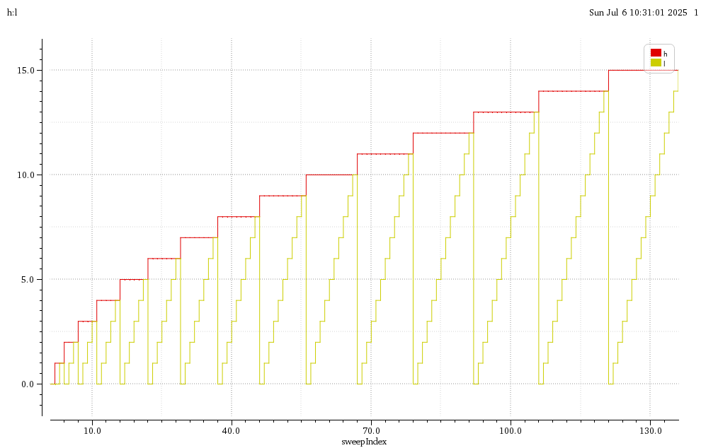

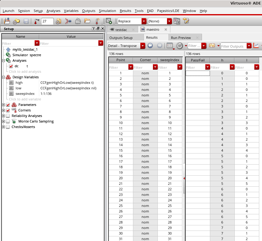

    Then create a sweep that sweeps from 1 to 136, and have two dependent variables:
    You can see the sweep combinations on the right, and also in this graph:
    You could then use my bussetp component from this article: How to sweep the value of the bussetp component using binary numbers to drive the bus input to each of your DACs.
