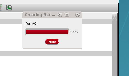

    Andrew Beckett over 1 year ago in reply to dogman4
    I'd be rather surprised, since it creates all the netlists up front and is blocked whilst it is doing so.
    Did you get a popup at the beginning of the simulation showing that it was netlisting. Something like this:
  • dogman4
    dogman4 over 1 year ago in reply to Andrew Beckett
    yes,it popuped.
    My test method is: I use config to simulate a comp, the comp contains two views, schematic and schematic_test, max jobs is set to 1.the comp is initially set to schematic, when I click on run simulationb after two minutes, then I change the comp to schematic_test.I looked in netlist and found that all simulations since then have used schematic_test.
