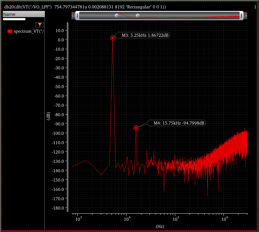

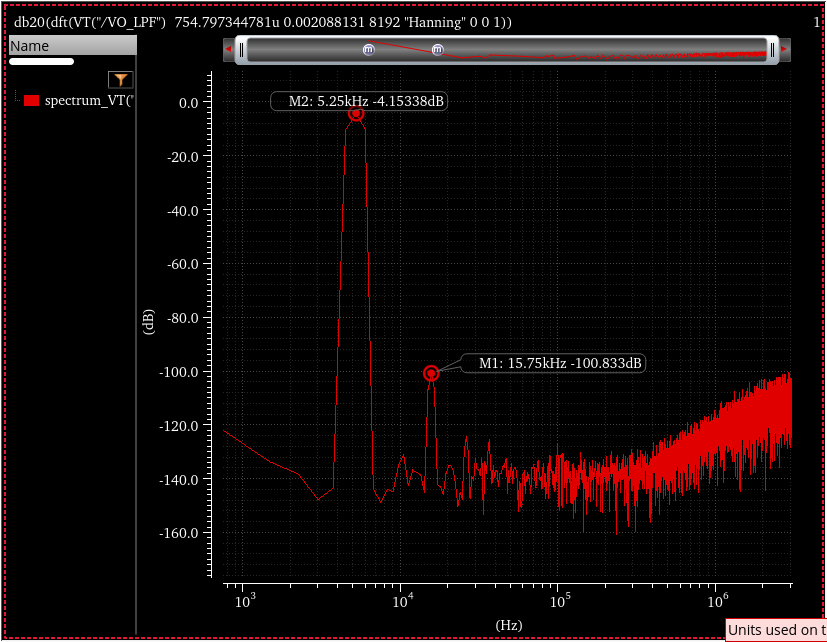

Dear all,
     I am currently running transient simulations for my circuit and would like to calculate the total harmonic distortion of the circuit.
     My spectre version is 23.1.0.362.isr5, and I ran the simulation using SpectreX -CX.
     Fig. 1 is the DFT result.  The circuit has a third harmonic distortion of about -100.8 dB.
     I performed THD calculations via two different approaches.

Fig. 1. DFT Result

The two results are vastly different for the same circuit and setup.
Approach 1 gave me -74 dB, while Approach 2 gave me -96 dB. I couldn't think of the reason why this was the case. Could you please help me out?

    I just noticed that your spectrumMeasurement is only looking at the frequencies between 20Hz and 20kHz, and so you're only going to be considering the 3rd harmonic in the THD calculation that way. Looking…
    It's hard to know for certain without seeing the raw data. One key difference is that both the DFT and spectrumMeasurement are using a window, whereas the thd function does not (so it's like using a rectangular window). It might be that the signal is not perfectly periodic or the small difference between the time interval and the fundamental you've given is not exact (it's approximately 7 periods by the looks of things).

    As for the input signal, I set it to a frequency of 5.25kHz and the number of cycles I used in the analyzes above is 7. The number of samples is 8192, and the sampling frequency is 6.144 MHz.
    For the first suggestion, I have tried to use a rectangular window in the spectrumMeasurement. This is the result I acquired.
    THD = -96.66 dB (Not much different from that using Hanning)

    I just noticed that your spectrumMeasurement is only looking at the frequencies between 20Hz and 20kHz, and so you're only going to be considering the 3rd harmonic in the THD calculation that way. Looking at your spectrum, there's quite a lot of harmonics at higher frequencies which are significant. thd() will be including all of them, and spectrumMeasurement is filtering many of those. A combination of the 200 argument (for number of harmonics) and the max frequency would make a difference. Maybe set the max frequency to 3M and harmonics to 670 or something like that and compare.
    Of course, it depends whether you want to exclude those upper harmonics in the THD calculation or not.

    After I set the range (750Hz ~ 3.072MHz), number of harmonics = 585, the THD value went down to -82.48 dB, getting close to that acquired using thd().  I think this is the main reason why I observed the huge difference between the two methods.
