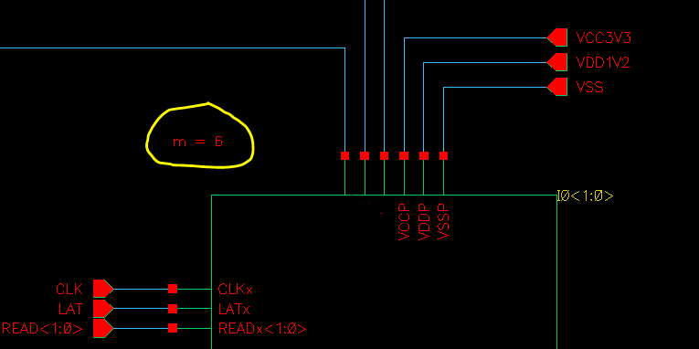

I am successfully netlisting and simulating a testbench 'config' view for Spectre with the primary instance pointing to a SPICE source file... (an extracted netlist w/ parasitics).
However, the CDF m= parameter on the symbol in the testbench schematic does not get printed in the netlisted instance call to the subckt.  I could use iterated instances, instead, to enlarge the circuit load (this works), but makes for a huge simulation when iterations are 1000's.  This is why I would like to use m= instead.
Below is the symbol instance within the schematic.  When netlisting the 'config' view, I0<1:0> is expanded appropriately to two instance calls I0<1> and I0<0>, but the mfactor (m=6) is not netlisted.
The interesting thing is - if I netlist 'schematic' view instead of 'config' view, the m=6 is printed at the end of the instance calls, as a parameter, just as expected, and simulates fine.
Any ideas on how to print m= in the netlist instance calls when pointing to a SPICE source file in the 'config' view?
Thanks,
Jeff

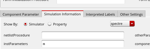

    Hi Saloni,
    Thank you very much.  This worked, although I also needed to add the term list from the Spice subckt netlist to the termOrder field as well as the 'm' to the instParameters field.
    Part of my confusion about this was that the m= parameter is added as the Library Scope for my library, so that it shows up as an option for every cell's properties.
    So, when I was adding the m to the instParameters field, I was doing this, also, in the Library Scope.
    For the solution to work, though, I needed to add the m and the terminal list to the Cell Scope instead.
    Thanks again!
    Jeff Beck
