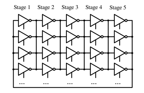

Hi everyone,
I recently updated several Cadence tools due to end-of-life notices for the versions we were using. After the upgrade, Virtuoso and Spectre launch without issue, but I’m now encountering a problem when simulating Verilog-A models — specifically with structural code using genvar and for loops.
The model in question is used to generate parametrized ring oscillator structures from a previously designed inverter module (RDUC_INV_V2). The structure chains a configurable number of inverters (N_stage), and then stacks delay lines to form a 2D array. Here is a picture as an example:
The code has run successfully in the past, but under the new tool versions it consistently fails with the following error:

After some debugging we suspect the issue is with how genvar is used in nested for loops to instantiate inverters and assign signals. The rest of the Verilog-A code — including different simple structural code — still compiles and simulates correctly. This points to a syntax compatibility issue and not a tool issue.
This is the code:

I’ve also tried restructuring the module to use the updated port syntax and a generate block explicitly, but the issue remains.
Has anyone run into this kind of issue with newer versions or seen changes in how structural Verilog-A is parsed? I'd appreciate suggestions on how to refactor the code for compatibility, or whether this is something that requires support intervention.
Thank you in advance!
