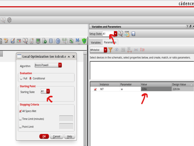

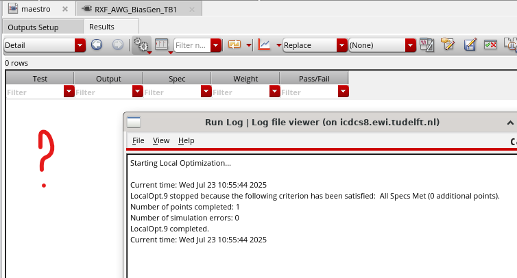

I am using Virtuoso 6.1.8.
I had the exact problem as in this post. Although I have a different version, following the solution solved the error. However, I receive no results.
I don't know what I am missing.

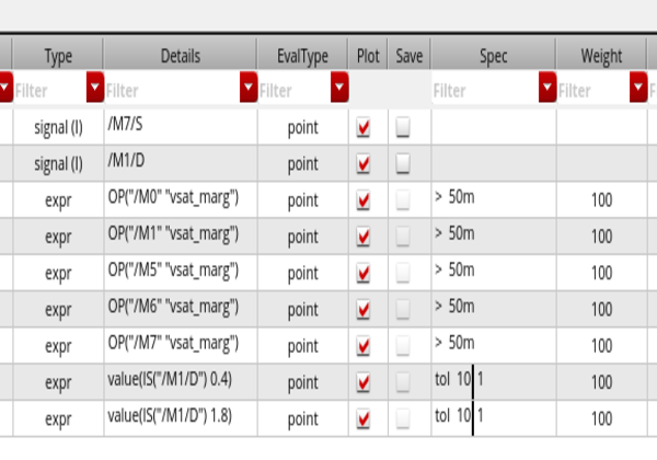

    Do you have any output expressions specified? You need to have at least one output expression with a specification (one of <, > or range, or the minimize/maximize if you want a goal rather than just a constraint). It looks as if you don't have any output expressions let alone specifications, which is why it appears to have finished after a single simulation - all specs have been met (all zero specs that is!)

    Yes, I do have some weighted expressions:
