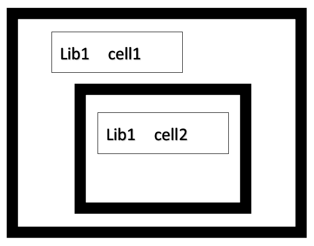

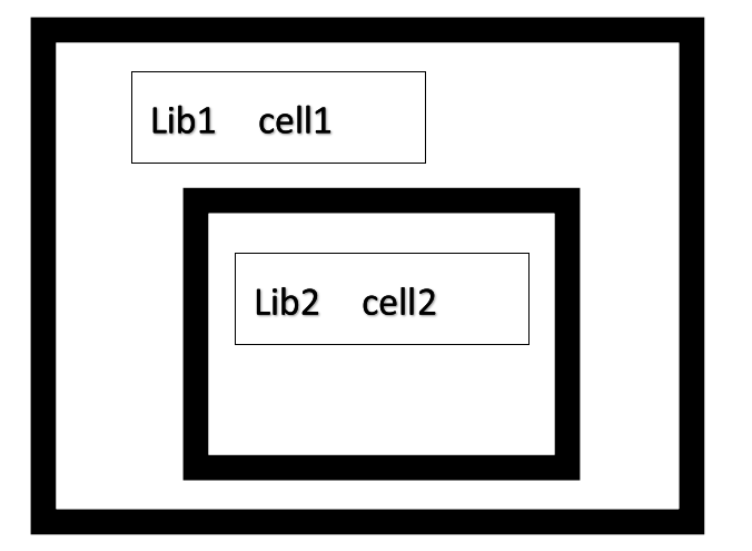

Hi,friends
I have a lib1 cell1 that contains lib1 cell2. I would like to replace lib1 cell2 with lib2 cell2 during simulation without modifying lib1 cell1 itself—using config or another method(The symbol of lib1 cell2 and lib2 cell2 are identical).
Is there a way to accomplish this?
