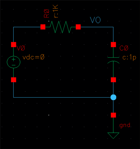

     I am analyzing the noise performance of a simple RC circuit in the 20-20kHz band.
     I have used two different methods in order to compare the differences.
     Method 1 (With .noise simulation):
     Integrated noise power at Vo (20-20kHz) = 331.2 fV^2.
     Expression used: integ((getData("out" ?result "noise")**2) 20 20000 " ")

    Method 1 can be checked by theory:
    Mean square noise voltage of a resistor is
    VRMS^2 = 4 * k * T * R * dF
    The RC filter can be neglegted here, because the RC bandwidth is larger than the applied integration range.
    So, assuming you used nominal temperature of 27°C:
    = 4 * 1.3806504e-23 * 300.15 * 1k * (20k-20)
    = 3.311903e-13
    = 331.1903 fV^2

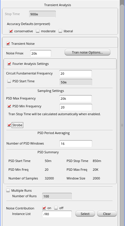

         1. If I would only like to analyze noise in the audio band (20Hz ~ 20kHz), can I simply set noise fmax to slightly higher than 20 kHz?  I understand that the higher the noise fmax, the higher the frequencies of noise I can see.   Extending from this, does that mean I will need to set the transient stop time to 50ms if I want to see low frequency noise at 20 Hz?
          i.e.    Transient Stop Time = 50ms (for noise=20Hz).    Noise fmax = 40kHz (for noise up to 40kHz. Taken slightly higher than 20kHz for margin).
         2. How do you choose the window size for psd?  Should I choose it to be the same as no. of samples?  In the example you have shown above, you have chosen window size = no. of sample / 16.
        3. Why is it the with noise fmax = 200kHz, the integrated psd result is around x10 higher than 323.1 fV^2?

    1.
    Yes, for a lower limit of analysis frequency at 20Hz, you need a at least 50ms Tstop. More would be better for averaging, as this will smooth the PSD, but it depends if you can afford the computation and on the required accuracy esp. at low frequencies. Note that also all analysis would happens only at multiples of 20Hz, if you need a finer frequency grid, you need an even larger Tstop.
    When using the transient noise options in the setup form, check the "PSD Min Frequency", then the form will calculate the minimum stop time for you. Also have a look in the Cadence Help, all the fields are actually explained.
    The noise Fmax would require more considerations; but as short summary:
    If the system filters high frequencies and there is no reasonable noise in the last decade of the PSD, or you can live with some error in the last decade, than generate the noise in the same band that you want to analyze and have the PSD same as the noise.
    e.g. 20kHz signal -> 20kHz noise -> 20kHz PSD
    If you analyze a region where the system does not filter the higher frequencies and/or you expect considerable noise power in the last decade of the region of interest, then generate noise one decade higher than the highest frequency. This prevents that noise bandwidth filter/PSD sampling affect the noise in the actual signal band. ("slightly higher" in terms of frequency analysis translates to "one decade"). Have PSD Max Frequency same as the noise bandwidth.
    20kHz signal -> 200kHz noise -> 200kHz PSD
    If you additionally want to see the behaviour of the noise bandwidth filter (that is builtin in the noise generation), then have the PSD one decade higher than the noise.
    20kHz signal -> 200kHz noise -> 2MHz PSD
    2.
    See the PSD Summary in the Fourier Analysis Settings (there is a checkbox in the transient noise setup). Just take these values to the analysis.
    3.
    The bandwidth of the noise is 200kHz, but the PSD is still 20kHz (with sampling at 40kHz), so everything above 20Khz is folded down into the 20kHz band, resulting in aliasing.
    IMHO it does not make any sense to have the Noise Fmax larger than PSD Max Frequency, as this inherently violates the Nyquist sampling theorem. With that you're just asking for trouble.
