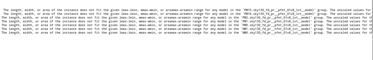

I’ve encountered an issue while running Monte Carlo mismatch simulations using the Sky130 PDK in Cadence. Even though all transistor dimensions are well within the valid limits defined by the PDK, the simulation fails and reports an error stating that the device dimensions are “out of the defined bound.”
It appears there might be a bug in the Monte Carlo mismatch model files for Sky130. Could someone please suggest a solution to it?
    What model files are you including in your simulations. From what I can see, the models have statistics blocks, but they are commented out. I can't see how Monte Carlo would even run... (I am assuming you're using Spectre). How did you set up the Monte Carlo run?

    However, I tried doing this - this is what I have in my spectre netlist (created from ADE):
    include "$KITHOME/models/sky130.lib.spice" section=tt
    include "$KITHOME/models/parameters/montecarlo.spice"
    include "$KITHOME/models/parameters/critical.spice"
    The first is the default model file that gets auto-added in ADE (I changed the path to have $KITHOME rather than the normal full path, as this makes it easier for me to switch kit versions).
    With the addition of the second two files (actually just adding the second causes this), a single (non-monte Carlo) run fails with:
    Reading file: /export/home/user/kits/sky130_release_0.1.0/models/sonos_e/begin_of_life.pm3.spice
    Error found by spectre in `sky130_fd_bs_flash__special_sonosfet_star', during circuit read-in.
      ERROR (SFE-1016): "/export/home/user/kits/sky130_release_0.1.0/models/parameters/../sonos_e/begin_of_life.pm3.spice" 30: Model `sky130_fd_bs_flash__special_sonosfet_star__model.0', the expected number of value followed by `l*w*mult' is 1, but found 0.
      ERROR (SFE-1016): "/export/home/user/kits/sky130_release_0.1.0/models/parameters/../sonos_e/begin_of_life.pm3.spice" 178: Model `sky130_fd_bs_flash__special_sonosfet_star__model.1', the expected number of value followed by `l*w*mult' is 1, but found 0.
      ERROR (SFE-1016): "/export/home/user/kits/sky130_release_0.1.0/models/parameters/../sonos_e/begin_of_life.pm3.spice" 326: Model `sky130_fd_bs_flash__special_sonosfet_star__model.2', the expected number of value followed by `l*w*mult' is 1, but found 0.
    Reading file: /export/home/user/kits/sky130_release_0.1.0/models/sonos_p/begin_of_life.pm3.spice
    Error found by spectre in `sky130_fd_bs_flash__special_sonosfet_original', during circuit read-in.
      ERROR (SFE-1016): "/export/home/user/kits/sky130_release_0.1.0/models/parameters/../sonos_p/begin_of_life.pm3.spice" 30: Model `sky130_fd_bs_flash__special_sonosfet_original__model.0', the expected number of value followed by `l*w*mult' is 1, but found 0.
      ERROR (SFE-1016): "/export/home/user/kits/sky130_release_0.1.0/models/parameters/../sonos_p/begin_of_life.pm3.spice" 178: Model `sky130_fd_bs_flash__special_sonosfet_original__model.1', the expected number of value followed by `l*w*mult' is 1, but found 0.
      ERROR (SFE-1016): "/export/home/user/kits/sky130_release_0.1.0/models/parameters/../sonos_p/begin_of_life.pm3.spice" 326: Model `sky130_fd_bs_flash__special_sonosfet_original__model.2', the expected number of value followed by `l*w*mult' is 1, but found 0.
    Also, looking in these files, there are no statistic definitions - there is in the "critical.spice" file but it's all commented out. I can't see how this would be working with Monte Carlo for you.
    If I omit the "montecarlo.spice" then the simulation runs (I leave the critical.spice included) as a single run.
    If I run with Monte Carlo, Spectre fails with:
    Monte Carlo Analysis `mc1': iteration = (1 -> 5)
    Error found by spectre during Monte Carlo analysis `mc1'.
      ERROR (SPECTRE-16012): mc1: Attempt to run Monte Carlo analysis with process and mismatch variations, but no variations were specified in the statistics block.
    Analysis `mc1' was terminated prematurely due to an error.
    Can you please share the model setup from the top of the input.scs? Have you modified any of the model files?
    Also, where did you get the PDK from? I got it from the Resources->PDK on http://support.cadence.com - i.e. sky130_release_0.1.0 (is that the version you're using?)

    As far as I can see, the models do not support Monte Carlo (at least in the current release). You should probably contact Skywater or Cadence Support (use the case menu to submit a case after logging in) to find out any further release plans.
