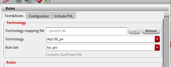

    Then when I ran Pegasus LVS, you can easily set up the technology and rule set as follows (the lvs_qrc setting will turn on saving of SVDB):

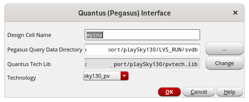

    Having run Pegasus LVS, when you run Quantus->Run Pegasus - Quantus, the form will be populated:
    As you can see, it's then pointing at the pvtech.lib and the technology - all of this is enough to find the qrcTechFile.

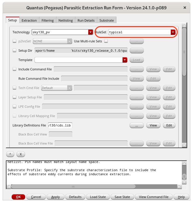

    Once this is OK'd you need to ensure you choose the Ruleset:
    Having done all this, it run OK - no errors.
