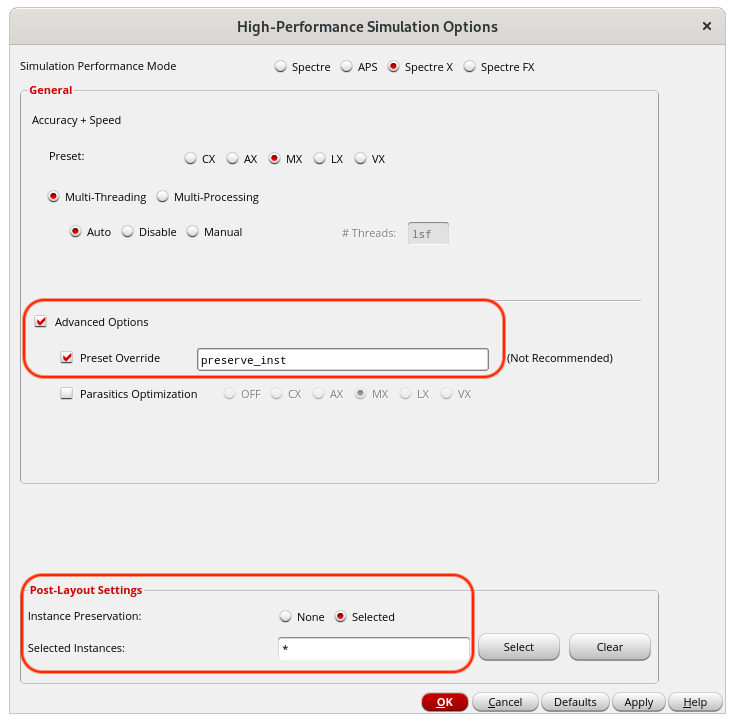

I'm trying to do a custom controller IC design for my thesis, using a commercial buck converter power stage.
The power stage that I chose is TI's CSD95373AQ5M, and the Pspice model can be downloaded here https://www.ti.com/lit/zip/slpm115. As I have took many days digging through all the posts regarding importing Pspice model into ADE Explorer for simulation, and still fail to find a completely successful solution, I decide to make a new post for some help.
The methods I tried are as below: (all of them are set to run transient for 50us )
1. I created a pspice cellview named 'CSD95373AQ5M' and created a symbol as prompted. Then I created a testbench schematic and setup all the test signals totally according to the datasheet's recommendations. After that, I created a config cellview and set the cell view for CSD95373AQ5M as 'pspice'.
Partial of output log is as below:

It looks like the simulator could interpret the subckt content, but it always stopped at some moment and couldn't finish the whole simulation period.
2. I also tried to use Setup -> Simulation Files -> Pspice Files to add my .lic file. It also couldn't work.
3. I tried the method according to this site. In essence it adds the .lic to model libraries for simulation. The output log said it couldn't understand the syntax in the .lic, which is also resonable to me.
4. I tried the method according to https://support.cadence.com/apex/articleattachmentportal?id=a1O0V0000091D0vUAE&pageName=ArticleContent&attachId=0690V000006N8jaQAC&sq=null&caseSessionKey=null
I followed it step by step and still couldn't make my model work on ADE Explorer. However, I did try another model, CSD97394Q4M using this method. But during the simulation, the output log still showed a lot of warning and oddly small time steps (as small as 1.5as) and stopped suddenly at 42.5us. When I plot the output it finally showed some reasonable buck converter waveforms. However, when I ran it again it just got stuck again.
I'm using a remote session for EDA tool and it doesn't allow file download nor copy paste outside of the environment, so I could only use AI to partially parse the texts for reference. I apologize in advance for insufficient information.
I also asked TI and they refused to give decrypted model (confidential from TI) and they don't provide support model use outside of PSpice. Since Pspice and Virtuoso both belong to Cadence, I hope I could get some help for pointing out what I am doing wrong or help me try out https://www.ti.com/lit/zip/slpm115. Or any alternative solution if this Pspice model just can't work on Virtuoso. I'm using Virtuoso IC6.1.8-64b.500.35
Any help is appreciated, thank you!
    Andrew Beckett 10 months ago in reply to WW202601034742 +1
    It runs (albeit complaining about convergence, and having to adopt a "disaster recovery algorithm") with Spectre Classic (i.e. not using APS or Spectre X). I did wonder whether post-layout optimisation…
    It runs (albeit complaining about convergence, and having to adopt a "disaster recovery algorithm") with Spectre Classic (i.e. not using APS or Spectre X). I did wonder whether post-layout optimisation might be getting in the way because of the ideal components (probably some in the model too), but turning that off didn't help. I can get it to run (with the same warnings about convergence) by using preserve_inst=[*]. However, otherwise it is complaining about some warnings within the protected block - it might be worth reporting this to TI alongside your circuit (although the team that builds these models might only be checking it with Pspice).
    We might be able to help you more with customer support too.
    Anyway, these are the ADE settings I used (I ran from the command-line, but these are equivalent). Note I was using a more recent Spectre version than you (which complained more about the model when it failed to converge). I did just check with the version you're using, and the workaround of using preserve_inst doesn't help there - it fails during the DC (whereas in the later version it fails during the transient). Using Spectre Classic does work in the version you're using though. For the record, I was using 23.1.0.802.isr17, 24.1.0.513.isr13 or 25.1.0.235.isr5 - all worked with the workaround.
