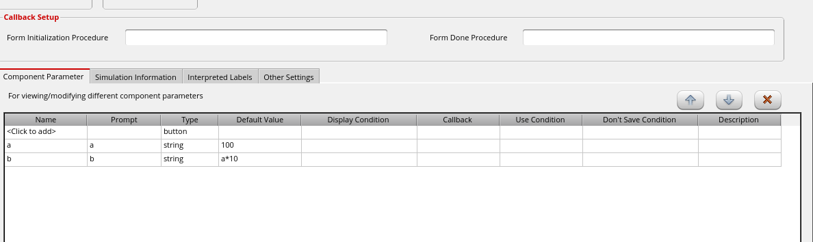

I am having some trouble understanding how to correctly implement some expressions in the parameters in my subckt model.
I have a model that I have defined as a subckt. To begin with, I defined the parameters on the circuit level, like:
simulator lang = spectre
parameters a = 100
parameters b=10*a
subckt test (N1 N2)
test_R (N1 N2) r=b
This works as expected, I can run simulations with the model and they work as expected. However, then when I create a symbol from this and add it to the schematic, I cannot edit the parameter a as it doesn not appear in the property editor, I can only edit the parameters directly in the spectreText file. So I add the parameters into the subckt, like:
subckt test (N1 N2)
parameters a = 100
         + b=10*a
test_R (N1 N2) r=b
This has the desired result, the parameters appear in the base CDF. I see them in Component Parameters. I can edit them on the schematic editor. However, when I run simulations, it netlists OK, but I get errors:
ERROR (SFE-1997): "input.scs" 14: Cannot run the simulation because xx: parameter `b': Unknown parameter `a' has been specified in expression `10*a', correct the expression and rerun the simulation.
Things I have tried:
  • Changed the parameter a to 'Evalution mode=number', and b to 'Evaluation mode=expression'. This results ina slightly different, but similar error.
  • Looked around the forums which seems to suggest I might need to turn on ParseAsCEL or something? But I cannot see this option in my Edit CDF menu.
My overall goal is to use multiple instances of this symbol/model, with slightly different parameter values, so perhaps I am going about this the wrong way.

  • GT20260122746
    GT20260122746 9 months ago in reply to Andrew Beckett
    Sorry, here's some more full models:
    The spectre.scs
    simulator lang=spectre
    subckt Parameter_test (N1 N2)
    parameters a=100
             + b=a*10
    test_R (N1 N2) resistor r=b
    ends Parameter_tes
    The input.scs:
    global 0
    parameters temperature=27
    I0 (0 net1) Parameter_test a=100 b=a*10
    I3 (0 net1) isource type=pulse val0=0 val1=1A period=10n delay=0 rise=1p \
            fall=1p width=1n
    simulatorOptions options psfversion="1.4.0" reltol=1e-3 vabstol=1e-6 \
        iabstol=1e-12 temp=27 tnom=27 scalem=1.0 scale=1.0 gmin=1e-12 rforce=1 \
        maxnotes=5 maxwarns=5 digits=5 cols=80 pivrel=1e-3 \
        sensfile="../psf/sens.output" checklimitdest=psf
    tran tran stop=100n write="spectre.ic" writefinal="spectre.fc" \
        annotate=status maxiters=5
    include "...spectre.scs"
    Which results in error:
    ERROR (SFE-1997): "input.scs" 14: Cannot run the simulation because I0: parameter `b': Unknown parameter `a' has been specified in expression `a*10', correct the expression and rerun the simulation.

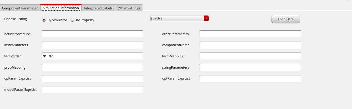

    And in the CDF (base):
    Thanks for your help.
    Andrew Beckett 9 months ago in reply to GT20260122746
    In the CDF, change the default value of b to either be blank (in which case it will use the default in the model if not specified), or to:
    iPar("a")*10
    which will ensure that it netlists the instance line correctly. Currently it is outputting b=a*10 on the instance line, and a in that context is the global a.
