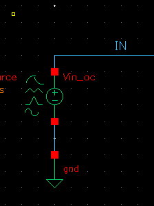

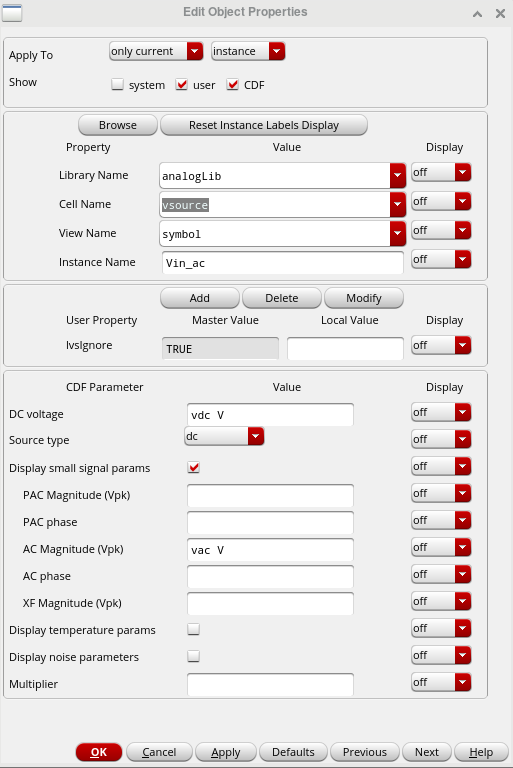

Hi, I'm trying to start ac analysis using ADE Explorer / ADE Assembler, but getting a warning that variable {V} is not set. I'm not using this variable, but it is always copied from CellView after command "Copy from CellView". The schematic files has no check errors or warnings, also parameters of vsource cell are set correctly (see image). Of course, I can set V to 0 value in ADE Explorer, and can simulate the results, but want to know why this unused variable always imported. Thanks.
